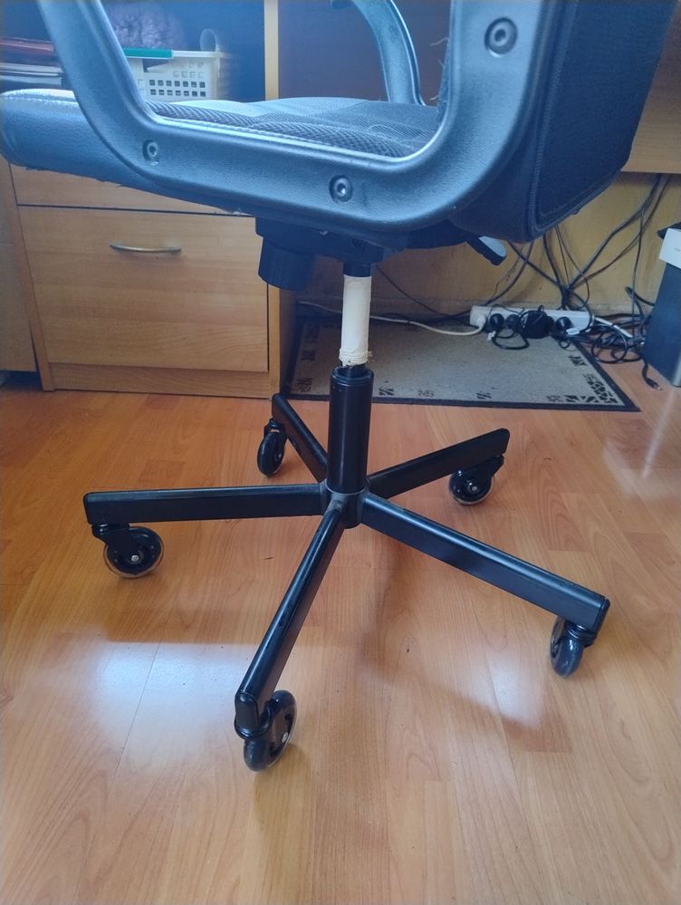

Remove all the castor wheels.
I am changing from 10mm plastic to 11mm steel so enlarged the holes with 11mm drill bit but the wheel pin would not tap in with the small hammer. Rather than change to 11.5mm (could end up to loose) I drilled again with the 11mm bit using a wiggle which worked out well.
Working my way around pushing them in with the thumb the tapping all the way down - all good.
