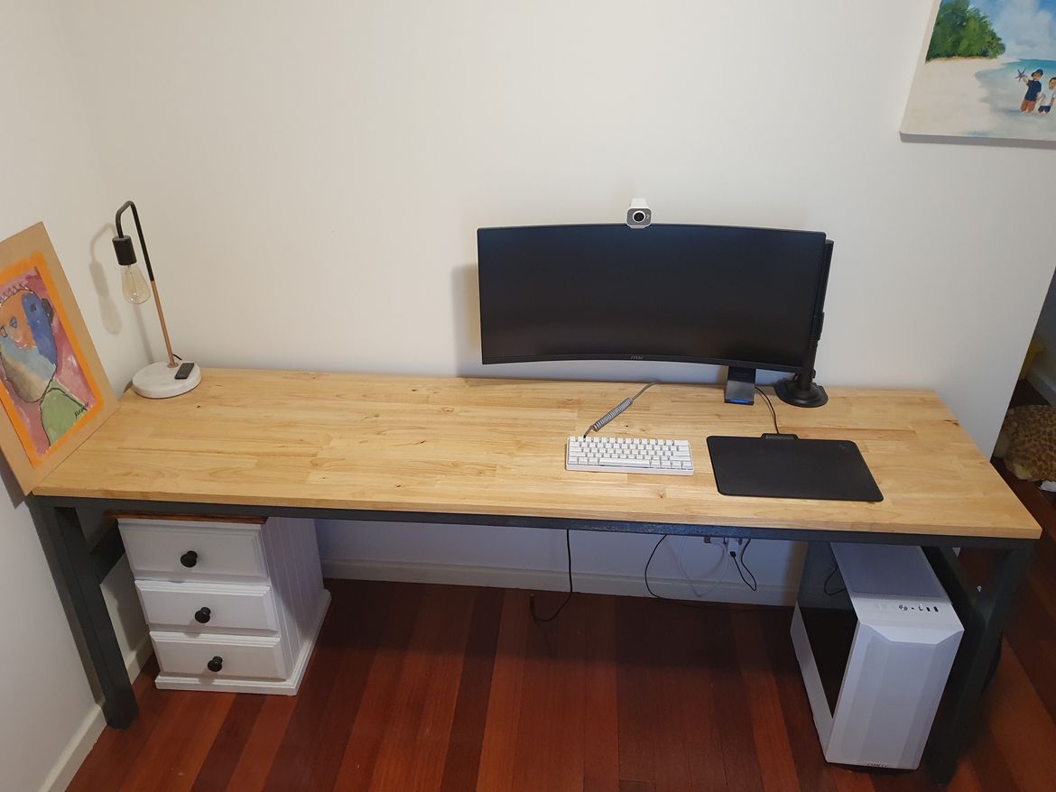

20210106_115353.jpegI thought I share my build for an affordable computer desk as most of us are now working from home. I needed an extended desk to fit into the study but couldn't find anything within my budget. My budget was under $150 for a 2-metre long desk. It's a straightforward build, and anyone can do it. It was my first desk that I have made.
Measurements
  • Length 2000mm
  • Depth 500mm
  • Height 790mm
Materials from Bunnings
  • untreated Pine 30 X 70 mm for the frame
  • Brackets for the legs
  • Wood screws
  • Worktop was 2200 x 600 x 26mm
  • Stain Linseed Oil (ikea)
  • Leftover white paint from Dulux (white on white)
Update: It has been six months, and the table is holding up well. I built another computer desk with my son for his room of similar size, and he loves it.

Re: Computer desk build
Hi @Corinney
It is the ALEX drawer from ikea. Its affordable and can store quite a lot of stationary.

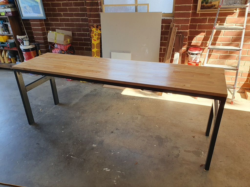

Thank you everyone for your positive comments. Just a quick update, I made another desk with my son and we changed the brackets to Carinya 75x75x25x2.5mm Zinc Plated Angle Bracket - 4 pack. These brackets are much stronger then the previous brackets. We also used a different top as he wanted a lighter colour, it was the rubber wood worktop that Bunnings was selling for $69 and then we painted his frame in Dulux Domino Black (2 coats). The colours go really well in his room and the best part of this build was that my son did most of the work and picked up so life skills.

Could i ask how you attached the top to the frame?

Hi @lhall,
To attach the bench-top, I just used silicon and then underneath the frame, reinforce with small L-shaped brackets. The brackets keep the top from moving and the silicon acts as the adhesive. Works really well. Good luck with your table, would love to see the finish product.

Thanks @rubytuesday1953 ,
It is super easy, I got the Bunnings crew to cut all the pieces to length and it took me about an hour with my son to build his frame. The painting takes longer and then the top goes on. I think the simple designs are often the best, and we like the provincial look as well. Good luck wth your table:-)
