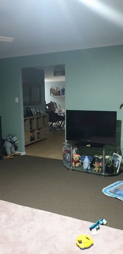

I would like to put roller door in my separate living room. Following are the pictures.
Here, you can see two different entryways to the living room.
One from Kitchen and another from the main door entrance. Since winter is here, I would like to close these two entries with roller doors so that I can get the maximum out of the Aircon. Plus, I would benefit by making this a private area by closing two doors and can be useful for my little one also ( 10 months) to play within.
There is some post about Barn Style sliding door in the Workshop forum, plus a few DIY project tutorials on the internet.
Apologies, I have not taken the exact dimension at the moment, but I can provide my next comments if needed.

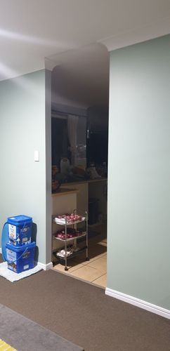

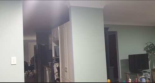

As you can see, one of the entryways (through the kitchen) is opened all the way to the roof ( the middle picture) while another is not entirely opened all the way through to the roof ( the last image).
I am looking for something suitable sliding door for this project. Any help with proper direction plus things to buy before I start, I would really appreciate it. I would also appreciate it if proper instructions are given to follow.

For the entrance that is open to the roof, you'd likely have to install a bulkhead for the track to be installed on. This will require some substantial work recreating that wall section. You'll then need to plaster sheet the bulkhead and blend it into the adjacent walls. I've created a rendering below as an example. The other doorway will be relatively straightforward, and installation instructions will be provided with your barn door track. If you have any trouble following those instructions, I trust our helpful members will be here to provide guidance. For your reference, here are the installation instructions for one of our Rolltrak barn door track kits. I'll include below a video from one of our supplier Hume Doors on how to install their door track. I'm sure you'll find it quite helpful.
