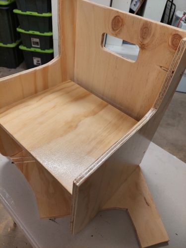

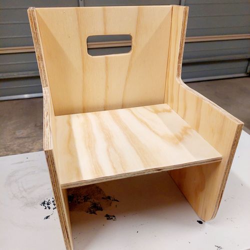

A bit of sanding and a couple of coats of varnish.

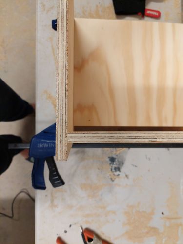

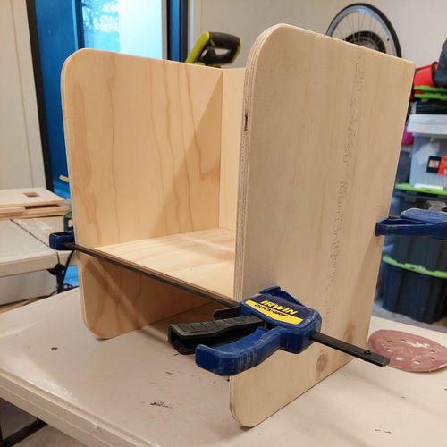

Clamping before screwing all the parts together

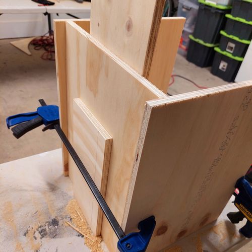

Initial pieces using 12mm off cuts to space out the back and seat inside

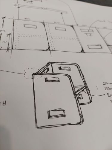

Original design based on using only one $24 - 1200x396mmx13mm piece of plywood.
