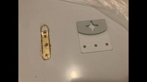

We don’t want to glue the mirror directly to the wall. So my plan was to glue new brackets (2 D-rings to align with the studs, plus 1 D-ring which, together with 1 original bracket, will be hung on a screw in a Ramset Super Wallmate anchors rated up to 20kg) onto the back of the mirror, which has a thin white plastic film covering.
Here’s what I’ve tried:
Attempt 1:
Glued EverHang heavy-duty D-rings (25kg rated) directly to the plastic film using Selleys Hold Up. After 72 hours, they peeled off easily with no effort.
Attempt 2:

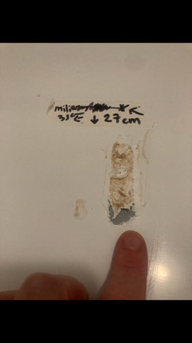

Removed all the Hold Up adhesive, sanded both the film and the D-rings lightly for better grip. Used Selleys Liquid Nails Original (green tube) and followed the instructions carefully. It looked more promising, but after 72 hours, a bit of force still made them pop off. (Pics show where they failed and one that I haven’t removed yet.)

The main issue you're running into is that the adhesives aren’t bonding properly because the white plastic film isn’t a great surface to glue to. It’s likely flexible, extremely smooth, and most glues struggle to stick properly to plastic in general. Even glues that are good with plastic can have trouble on surfaces like this. You'll note the manufacturer's mounts have a much larger surface area and are attached to the back of the mirror and not the film.
That said, even if the adhesives worked better, I’d strongly recommend against trying to glue D-rings to the back of a 20kg mirror. The D-rings you’re using are designed to be screwed into timber frames, not glued onto plastic or mirror surfaces. Their fixing plates just don’t have enough surface area to safely support that kind of weight.
For something as heavy as a 20kg mirror, you really want proper fixings — and they need a good safety margin above the mirror’s weight. Also, two 20kg-rated wall anchors don't automatically equal 40kg of holding strength, because the load isn’t always evenly shared between the two points.
All up, I'd say if you can’t use the original mounting points provided by the manufacturer, it’s safer to look at choosing a different mirror that better suits your wall fixing setup rather than trying to retrofit additional brackets yourself. I know that’s probably not the answer you were hoping for, but safety-wise it's definitely the best call.
