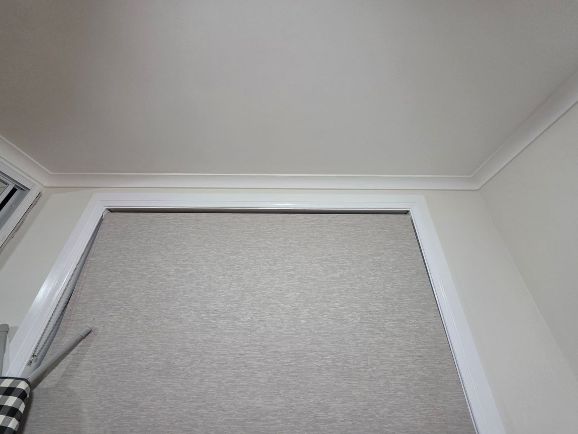

Re: How to attach new cornice with existing corners?
Hello all, Been awhile! I finished this cornice back in June I think. I ordered an Exact match here in Canberra and cut to size etc. This can be done! I only replaced a single bit but I reckon (lol) I could do a whole (small) room but it would be tricky! I used cornice cement, just the DIY stuff, used a small spatula to fill in the gaps and corners, smoothed it all over with a cloth/sponge and gave it a sand a few days later. Looks fantastic and has been painted fully only a few weeks ago! Just thought I'd post for other people to see it can be done! Length is 2.7m, was good to have to the old bits so I would advise to at least keep the corners to try and match them up. I used a Japanese saw to cut the angles, sort of a 45 degree tilt, anyhow! Cheers!Completed pieceCompleted pieceRighht hand cornerRighht hand corner

Hi @geoff_70,
I have only done a little bit of cornice in my life, and there is a bit of an art to it. For a first attempt, you have done a magnificent job, and now that it has been painted, it looks like it has always been there.
Thanks for the update.
