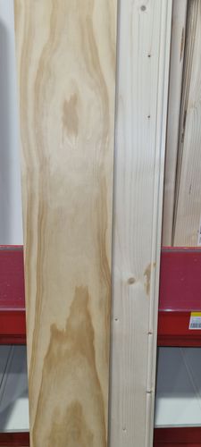

Can you see the difference of pine board and pine dar. will it look bad when I join them together .
I do have a plan to varnish them will that difference will be cover after staining ?
Thnaks
Hassa
Hi @shaqqi,
They are both pine, so if you do stain and then varnish them, the difference in colouring should be minimised.

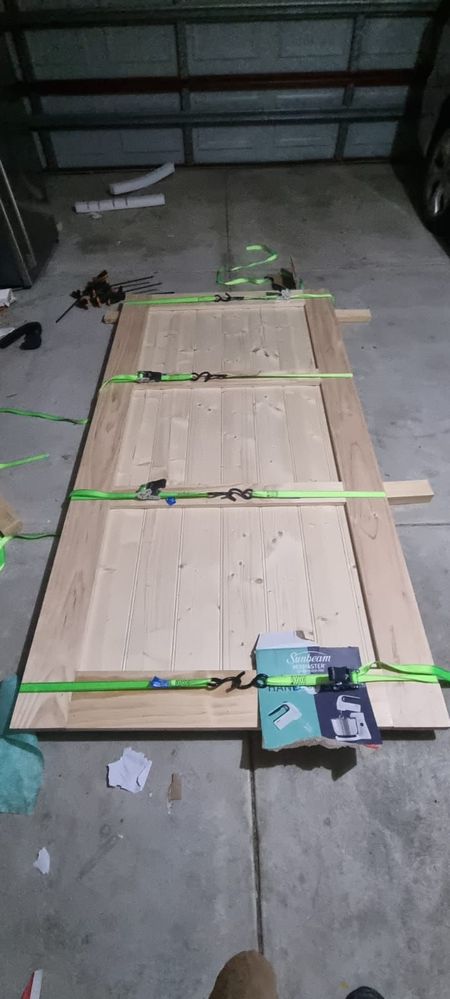

I am in the process of making the barn door as you can see the attached pictures
Now have some queries
Lining board side edges i have cut to the required width now what is the best way to make both side surface as smooth as DAR pine of frame
Furthermore, moving forwards please recommend what tools shall i use for sanding and staining the door.
Shall i used manual sanding block or machine sander (there are so many different type orbital sander, sheet sander, detail sander)
and for staining manually with cotton rag or sprayer (if sprayer then suggest which sprayer will be best suited for staining as well as wall painting which i can use in future.
Thanks
Hassan
Hi Hassan (@shaqqi),
Great job on the barn door so far! To smooth the edges of the lining boards to match the DAR pine frame, you can certainly hand sand using a sanding block to get a smooth finish. However, using a detail sander would make the job quicker and give you more control, especially for smaller or more intricate areas. A random-orbital sander would also be a good choice, possibly allowing it to be used on a wider range of projects in the future. I recommend checking out this guide on How to choose the right sander for the job, which will walk you through the options based on the type of work you’re doing.

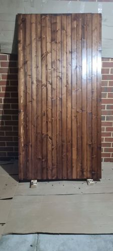

Hi Mitch,
We have selected Cabot Interior Stain Oil Based (Cedar) & Cabot’s Cabothane Clear Oil Based and using hand brush for application
I have done the sanding with grit paper 120 and 180 before application of stain.

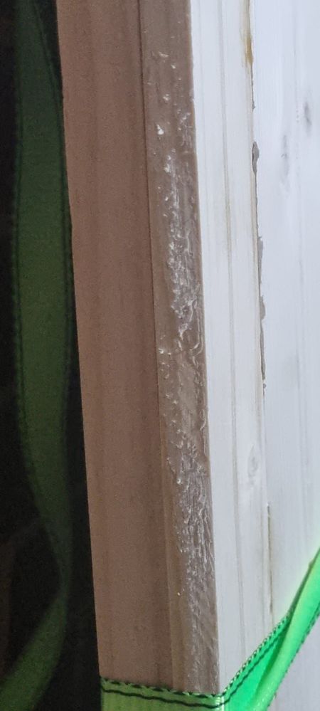

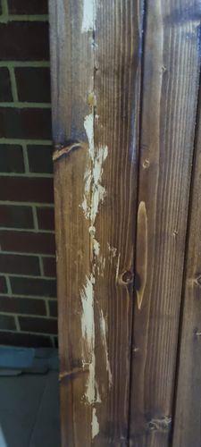

After applying interior stain oil based, below marks are appearing (pics attached). These are more likely of wood glue that is not letting stain to show wood grains. Can you advise what shall i do to remove this wood glue. Thanks
Hello @shaqqi
I recommend using your sander and sanding the surface more thoroughly until the sections with adhesive have been removed. You can clearly see which parts have been covered with adhesive and where you need to focus your efforts. Once the surface is free of adhesive, I suggest doing a test and applying some stain, observe carefully if the surface will accept the stain. Any section that rejects the stain will need more sanding.
Which grit sanding paper to use ?
