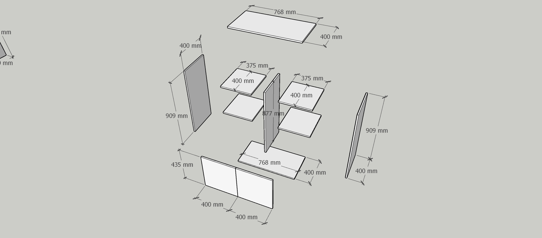

Cheers, how much do you think this will cost?
and can you show me your drawing of cabinet final build.
Re: TV Units
Hello @Robisgreat
I've placed the sketch of your cabinet below. The measurements are for reference only, please double check the sizes before you cut the panel. Each CUSTOMwood 2400 x 1200 x 16mm Raw Standard E0 MDF is currently priced at $42 dollars. I suggest using Zenith 8G x 40mm Countersunk Rib Head Chipboard Screws - 28 Pack to screw the panels together. Please make sure to drill pilot holes to prevent splitting the wood.
