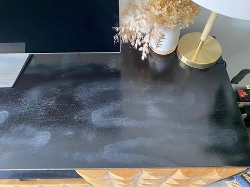

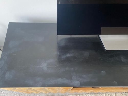

A can of bug spray has left unsightly white marks all over our wooden TV stand. We have tried most of Dr Google's suggestions from wiping down with soapy water, through to, using an iron/ cloth and even mayonnaise. Would anyone have any suggestions as to how to go about removing these stains without ideally having to sand/ repaint or coat?

I am sorry to see that you've not had any luck removing the stain. Unfortunately, I believe that the bug spray has reacted to the finish on the TV unit, and it is not possible to remove the stains with a chemical agent. This could be because the finish is made of shellac, which can react to alcohol in the bug spray, similar to nail polish and nail polish remover.
Unfortunately, I believe the only way to fix this is to recoat it. Luckily you will not need to completely remove the coating, it should be fine to sand the surface back to remove any waxy coating using Flexovit 115mm x 1m 120 Grit Timber Sandpaper Roll and then paint over.
You might even find that you like the look once it is sanded back and would like to just apply a clear coat over the top such as Dulux 325g Duramax Matt Clear Coat Spray Paint.

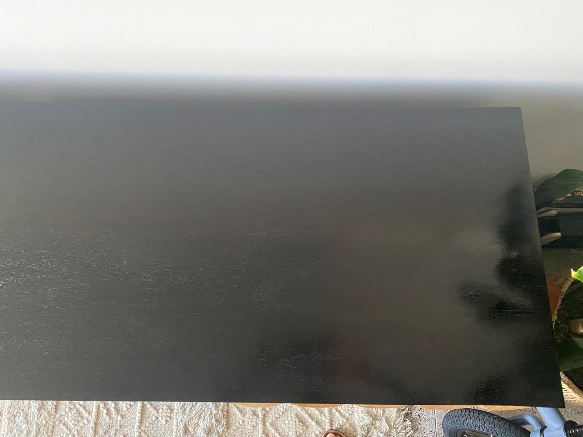

Hi Gents, black wax ended up taking care of the issue quite well. Avoided having to sand/ re-stain/ paint.
Hi @Suhas,
That looks brilliant, I could never tell there was a problem if I hadn't seen the before photo. Awesome work!
