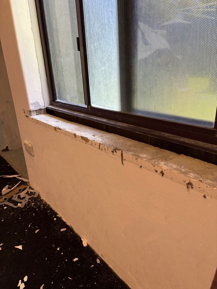

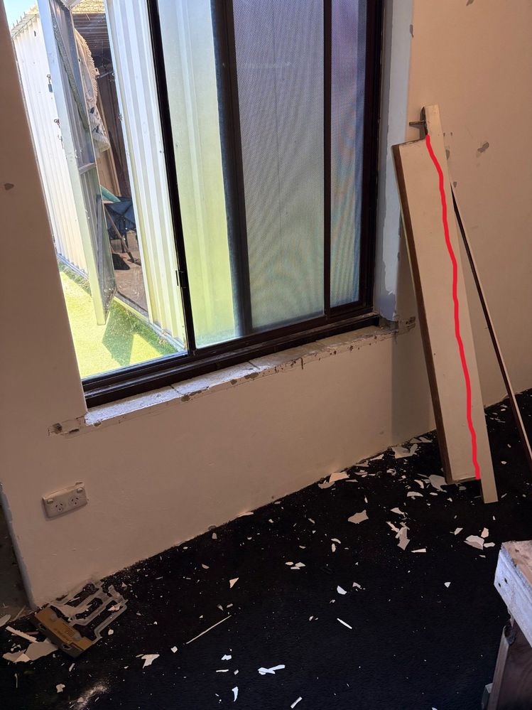

As per the images below I removed the timber board under the window as it sticks out and no furniture can fit, can you advise how to fill this hole now and make it flush with the wall… thoughts are to cut the board flash and refit but what else ?

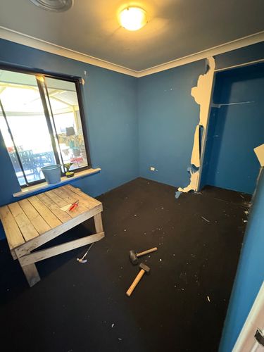

The rooms are quite dark and want to get lighter with the colour, art we bought brilliant white, is there any better colour options that will make the room brighter?

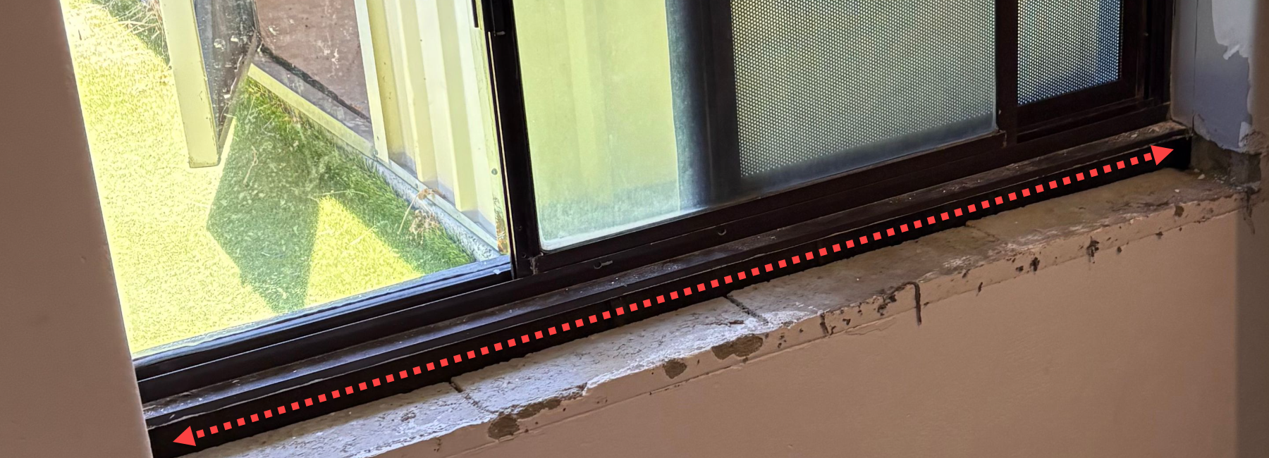

Is this part of the aluminium frame, or is there a gap here?
Cutting the sill back so that it sits flush with the front of the lip is likely the simplest option, as it will conceal everything it did before; you would just have to touch up the corners with a suitable filler and seal around it. The alternative, based on the fact that your walls appear to be rendered, is to install a render bead on the front lip and then render and fill everything to match the walls. This is why I ask if there is a gap, because this would need to be concealed if you were to do this.
For dark rooms, light-filtering roller blinds or sheer curtains work well. They let in softer light during the day while still giving privacy. If you'd like to do it yourself, you can check out How To Hang Curtains and How To Install Roller Blinds, or you could use our Curtain, Blind & Shutter Installation Service.
Swapping the existing fixture for a brighter LED oyster light could be an option, as they tend to spread light more evenly in darker rooms. If you want something decorative, a pendant light can work too, as long as the ceiling height allows. Keep in mind that any electrical work will need to be done by a licensed electrician.

I’ve got a gap of about 30mm under the window lip. To address this, I cut the timber back flush with the wall and reinstalled it. I was advised that I could apply Bondcrete to the timber surface and then render over it, as Bondcrete would help the plaster bond to the timber.
Can you please confirm if this approach will work? If not, what alternatives would you recommend? It’s a fairly large gap to fill, and I’d like to bring it back.
red line approx. cutting in straight linered line approx. cutting in straight lineGap under the window frameGap under the window frame

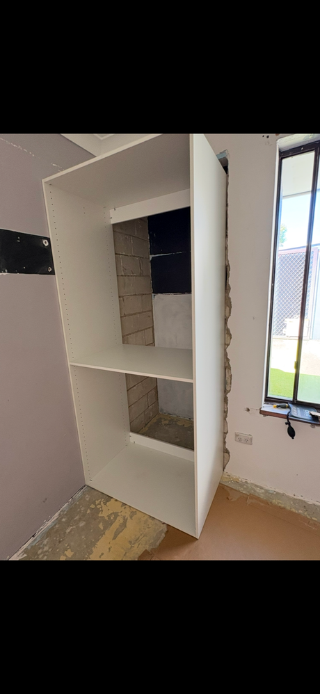

Build in wardrobe installation(Lugna) : - Flex Storage does not have a 900mm options at all.

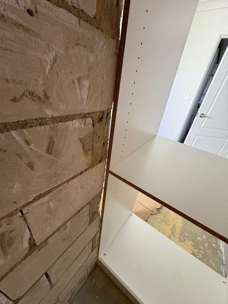

The shell does not fit for about 2-3mm so I m thinkg to grind back the bricks, couple of questions:
  • After removing the render from the wall (it’s an external wall rendered on the outside), do I need to seal the exposed surface where the render was removed? Could leaving it unsealed cause any issues in the future, considering the wardrobe side will sit flush against the wall?
  • How can I repair the broken corner I had to cut to fit the shell? I want the wardrobe to sit flush with the wall, and there will be two doors opening at the bottom.
A1
I have not tried rendering over timber, so will have to leave a recomndation to one of the others :smile:
A2
I probarlly wouldnt grind back the brick work, That is a fairamount of grinding/dust (If you do make sure you wear protective breathing gear) I would be tempted to modify the cabinet and shelves. There are 5 fixed pieces after you remove a side that you could trim back 5mm- 10mm and then rejoin the side.  I wouldnt seal the exposed surface. It may be fiddly but I think it would be easier than to reduce the wall itself by 3mm.
Fixing the edge to be sharp I would use UNi-PRO 500g Multi Purpose Interior Filler - 500g
One thing to consider is the left door opening. With the area so tight you will end up with the door handle impacting the wall or not being able to open. I would maybe reduce the width by another 10mm to accomodate this.
