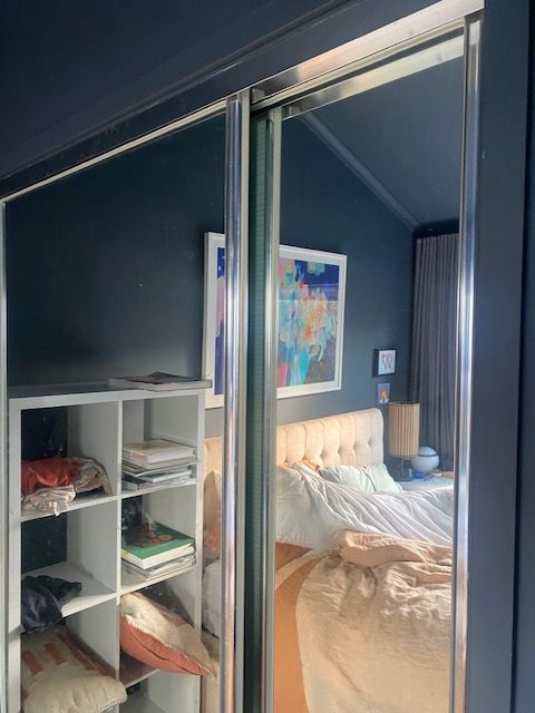

Any ideas on how/what I could cover my glass wardrobe doors with.  Can I glue something to it and paint it eg VJ panelling? too heavy? IMG_1881.jpg

Welcome to the Bunnings Workshop community @kelbie. It's wonderful to have you join us, and many thanks for your question about covering glass wardrobe doors.
You have a few options for covering your glass wardrobe doors, depending on the look you want to achieve. Lightweight materials like frosted film or self-adhesive film can provide a simple and removable solution. However, attaching heavier materials like VJ panelling, MDF, or plywood directly to the glass isn’t recommended, as it could pose a safety risk and put extra strain on the rollers and guides, leading to premature failure.
If you're looking for a more solid look, having a professional replace the glass panels with a lightweight alternative, like painted MDF or acrylic sheets, could be a better option.
