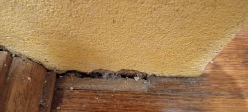

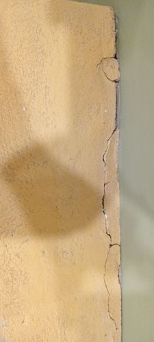

I'm getting ready to paint this fireplace wall but before I do, I am wondering if there is a pre mixed filler (one I don't need to mix myself) to fill these cracks and chips in the concrete? If not I'm thinking to clear away as much debris as I can and painting it anyhow. So far we have spent close to $5.000 on Reno's so want to start saving a bit on non essentials.

I agree, renovation costs do tend to pile up after a while. I suggest using Earl's 500g Concremate Expanding Cement to fill in all the gaps in the concrete. My best advice is to remove as much of the loose concrete bits before using the filler.

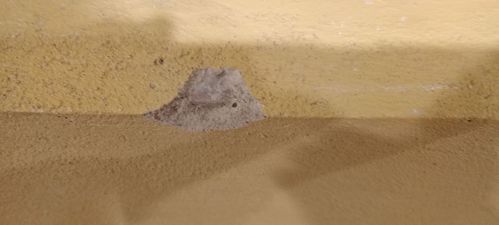

Ok will give it a try. Not done it before so will post pics of how it turned out

I'm also wondering what grit sandpaper I should use when sanding back? It all came out pretty dark and wondering if it will lighten when I sand it back a bit? We bought Taubmans 1 litre paint to paint the wall surrounding the fireplace so don't want it blending in with that.

Sanding is not going to lighten the colour, but it will lighten as it dries.
I wouldn't usually recommend sanding a cement-based filler. These surfaces are textured anyway, so you shouldn't really need to and it would make the patch look different to the rest of the wall.
Once it is dry, have a look and see what you think. If you absolutely have to sand it, make sure you wear a mask and use 80-grit.
