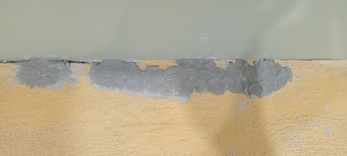

I'm getting ready to paint this fireplace wall but before I do, I am wondering if there is a pre mixed filler (one I don't need to mix myself) to fill these cracks and chips in the concrete? If not I'm thinking to clear away as much debris as I can and painting it anyhow. So far we have spent close to $5.000 on Reno's so want to start saving a bit on non essentials.

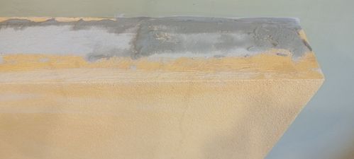

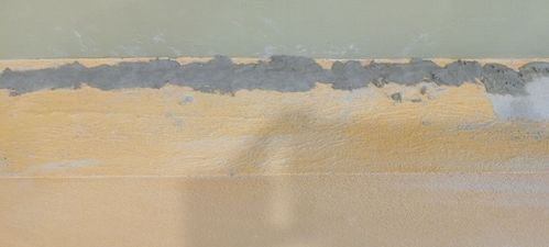

Well this was my first time doing this sort of job and mixing in concrete. I don't think it turned out too well but I feel I'm going to need to sand it back. I knew it lightened as it dried but this was a particularly difficult job for the less experienced.
Re: Mixed filler for cracks in concrete.
Hello @Innov8tive
Thank you for the update, the patch job looks very good. I suggest following @JacobZ's suggestion of using an 80grit sandpaper to level the surface. I recommend using a UNi-PRO Cork Sanding Block for a nice uniform finish.
