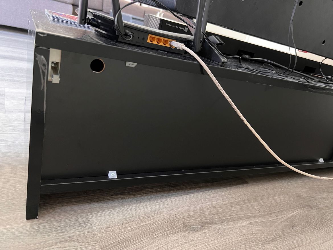

I am attaching a few pics for reference.

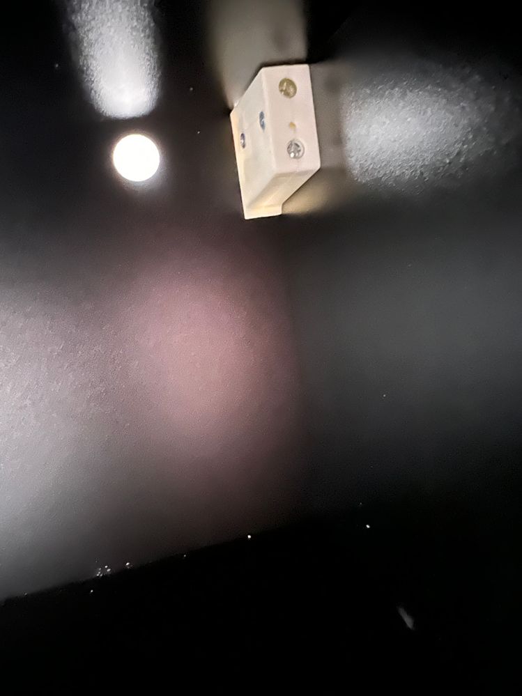

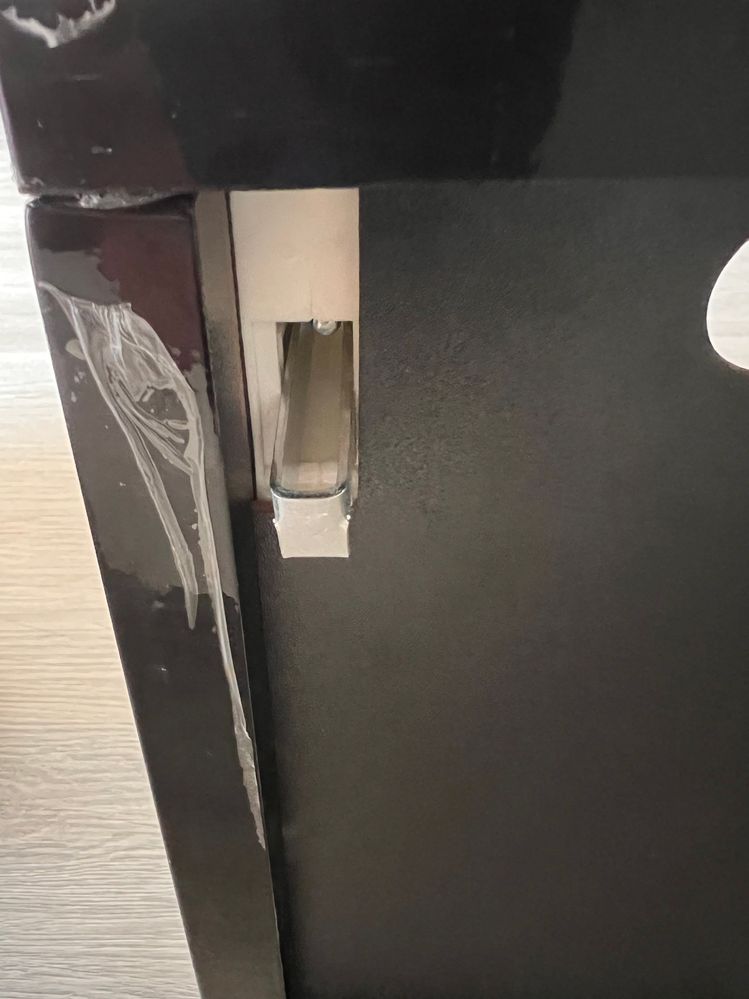

Any suggestion or help would be much appreciated Outside of Hook which hangs to plate
Hook inside the Unit

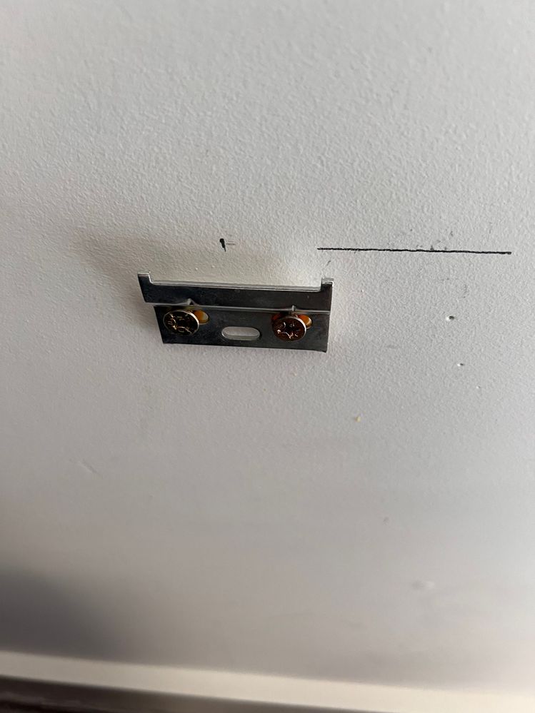

wall plate
