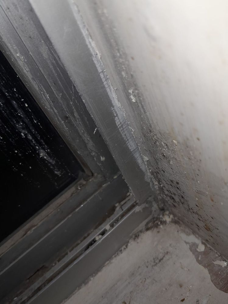

I applied the paint stripper to the Aluminium frame but did not have much look.
I then tried sanding the frame down and that seemed to make it a bit better but the tool I have is a round sander so not much surface contact area.
I then tried applying paint stripper to steel wool and going through the Aluminum frame, that seemed to yield better results but nothing outstanding, what should I do now?

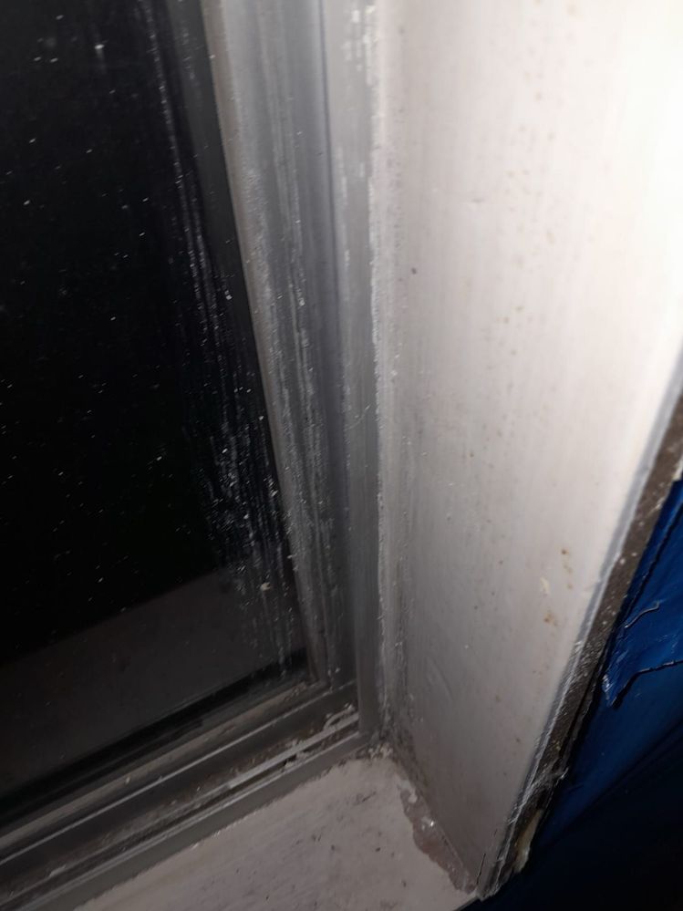

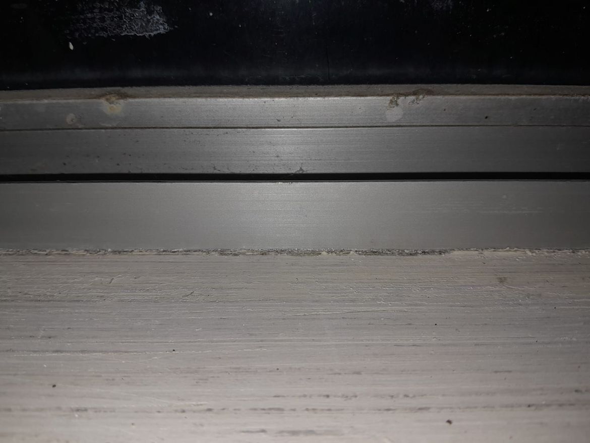

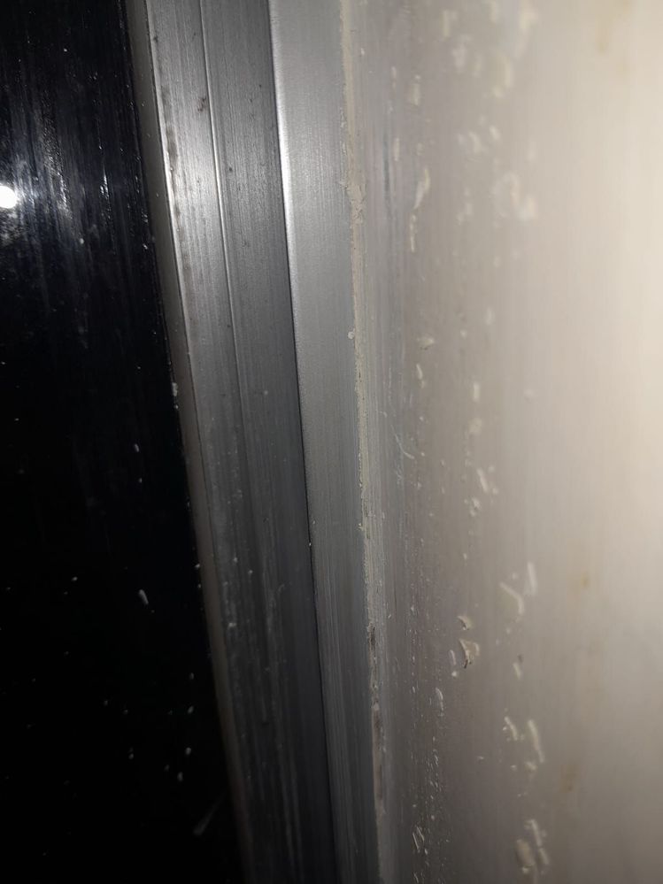

The paintstripper will work, its just not fast. Any chance of a photo of the window/paint that you have stripped?
Hi @Dave-1 , @EricL , @JacobZ , @MitchellMc
Yeah, there has been some progress, see attached photos (focused only on the Aluminum Frame).
I guess from here, it is more stripper and elbow grease - unless there are other suggestions?

More stripper. You can see it working, just take it slow and easy and follow the paint strippers directions, dont do a large section all at once, small section, time and then scrape that layer away. It will take a few coats id say. Once most is away then you can clean up the areas and sand the paint on the timber smooth again to prep for repainting.

It's starting to look good.
As @Dave-1 has said, keep at it you're almost there.
If you don't already have one, these Kincrome Safety Folding Scrapers will be great for cleaning up those little bits left over.
Just make sure you wear gloves when using them as they are fairly sharp.
