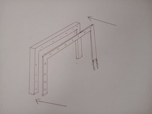

I was actually meaning a metal piece to give that strength whilist minimally changing the overall look of your side table
Even a local welder/boilermaker place in a light industry area near you could cut a few out I am sure if you dont have the skillset
(My metal cuts always go straight then angle down and away lol )
@Dave-1 my bad misunderstood. I probably do the dowels and see how it feels first. The L shaped metal bracket though, is it sit at the outer layer of corner edge between tabletop and tableside, and requires screws? if so, it is then easily visible when we look at the table?
Morning @alfredx
I was actually thinking of sandwiching it between the outermost layer and the second, with small countersunk screws (and countersunk metal holes) facing inwards to the next piece of timber. so the only thing seen would be a thin silver strip.
The larger holes on the thin piece is the coutersinking, you will screw through into the first section of the timber. The countersunk holes will be deep enough that the screw head nestles in nicely so you have a smooth surface to glue the next batch of timber on.
