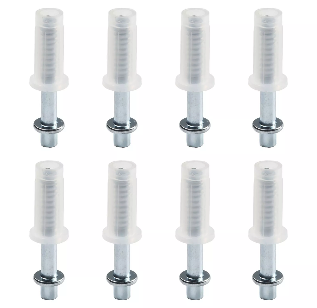

Spring loaded bi-fold door pins!!!

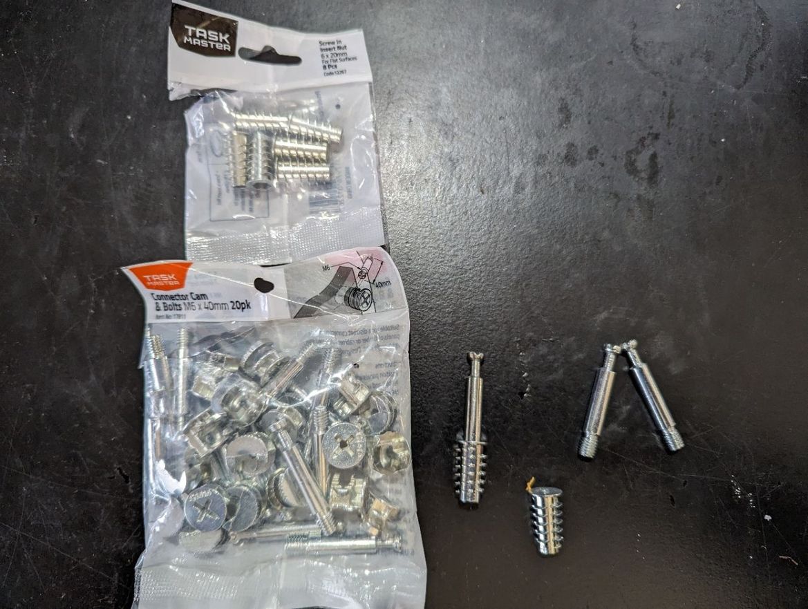

I've added to the idea to make it very easy! Im using these guys to mount the bottom of the slat. I just need a hole bigger than the pin to if freely rotates. Then use the spring loaded bi-fold pins to secure at the top.
Thanks to Noyade for the OG idea to use the connector cam pins in the plan too!~
