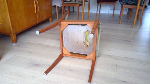

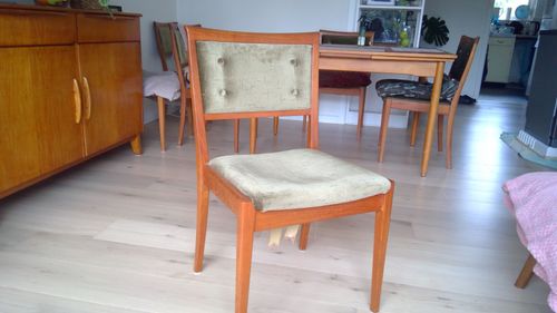

Looking for advice please on how to restore the seats of these gorgeous Fletcher Parker chairs? I wish to maintain the fabric - is still intact without rips.
Seems I will need to replace the strapping and foam stuffing? Have not done before.
Is it difficult?
Chair frames are mostly sturdy, but could probably do with strengthening - is that re-glueing? and how to do?
Or should I just be handing to a professional?
I would like to do myself though if not too tricky.
many thanks in advance,
Loren

If the fabric is still in good condition, you'll need to remove the seat as a whole and trace the strapping which is possibly made of Jack 50mm x 33m Jute Webbing Plant Tie or similar fabric. The foam is filled back in first and then the strap is stapled to a timber frame.
That would be the quick way to restore it, however, the professionals would remove the timber frame and put in a new foam seat and reupholster it. This is on the condition that the fabric can withstand the stress the new foam exerts on the fabric.
In regards to the chair, if there are screws that can be re-tightened then that is the most I would suggest doing. Drilling new screws if not done properly could compromise the chairs strength and stability.
I suggest having a quick look at this discussion - Chair restoration by @pepsp.
