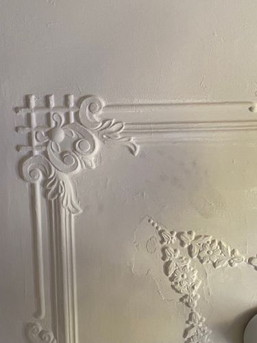

This is a corner of the ceiling rose where we have scrapped off some of the old paint to reveal the plaster which took a couple of hours!
So far from my understanding, I have two options:
(A) Try Peel Away 8 to see if it would be more efficient in removing coats of paint on the ceiling rose, or
(B) Gently sand back as much as possible. If encounter paint that has peeled off, use Zinsser Peel Stop to seal it, then patch, sand and lastly prime before paint.
What would be your advice?
Thanks again for your help!
Re: Indoor paint preparation
Hello @Curious_Bee
I would go with step (B) and that is to gently sand back use Zinsser peel stop then patch, sand and prime. It would be labour intensive, but if carried out with patience you should achieve a nice clean finish.
