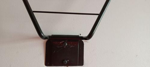

I have tried everything I can with all my tools to remove these screws. Spanners, screwdrivers, adjustable spanner and reverse drill. They are very tight in the drywall. Unfortunately people that did repairs just didn't do any of the jobs properly so there's been a lot of hassles. I simply don't have enough leverage or force with any of my tools to get this out. Alot of things are fixed to plasterboard walls.  I'm having this issue with alot if things round the house so looking for something that will definitely work for tight screws and ones that have been screwed in on the wrong angles.

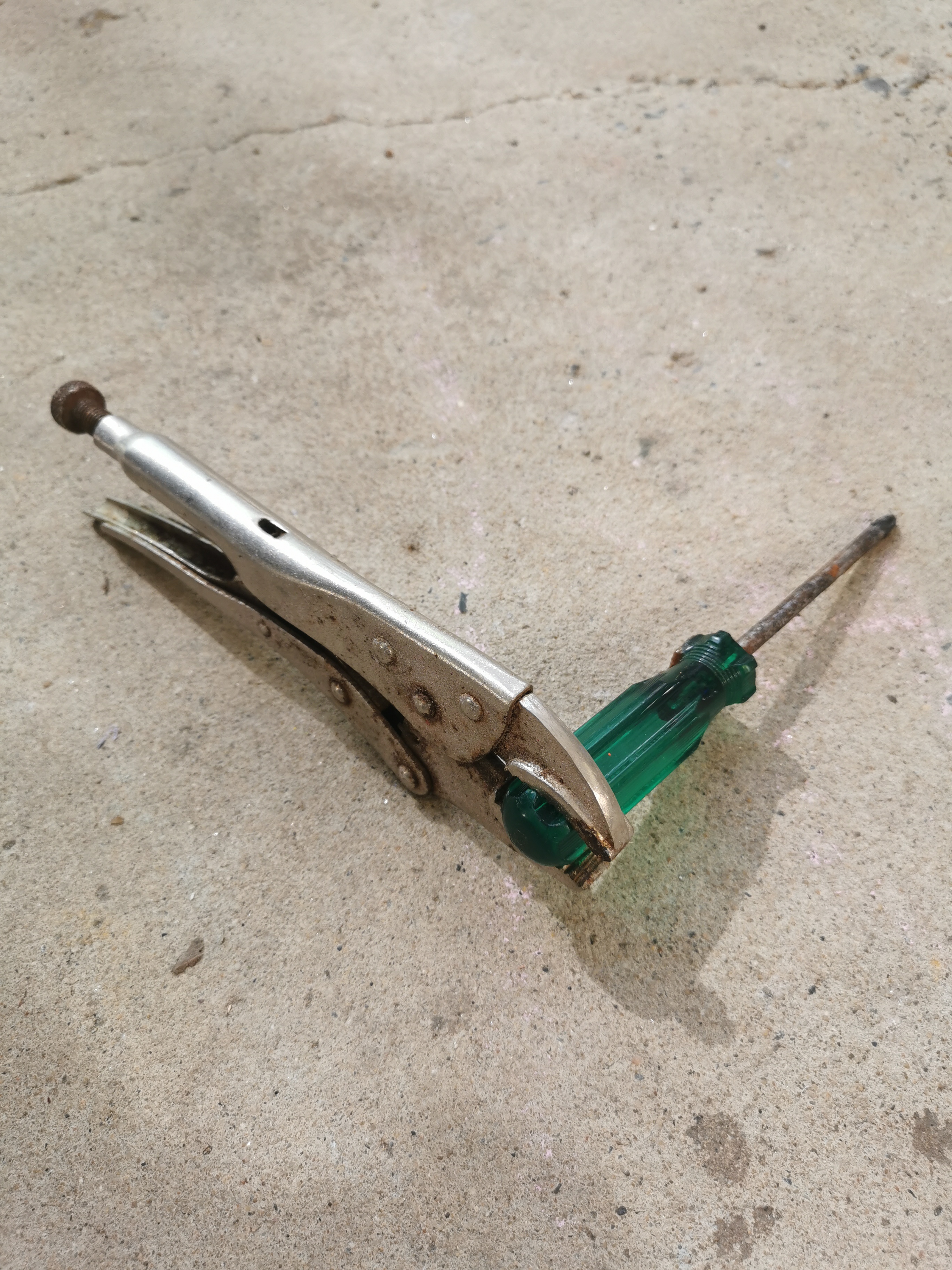

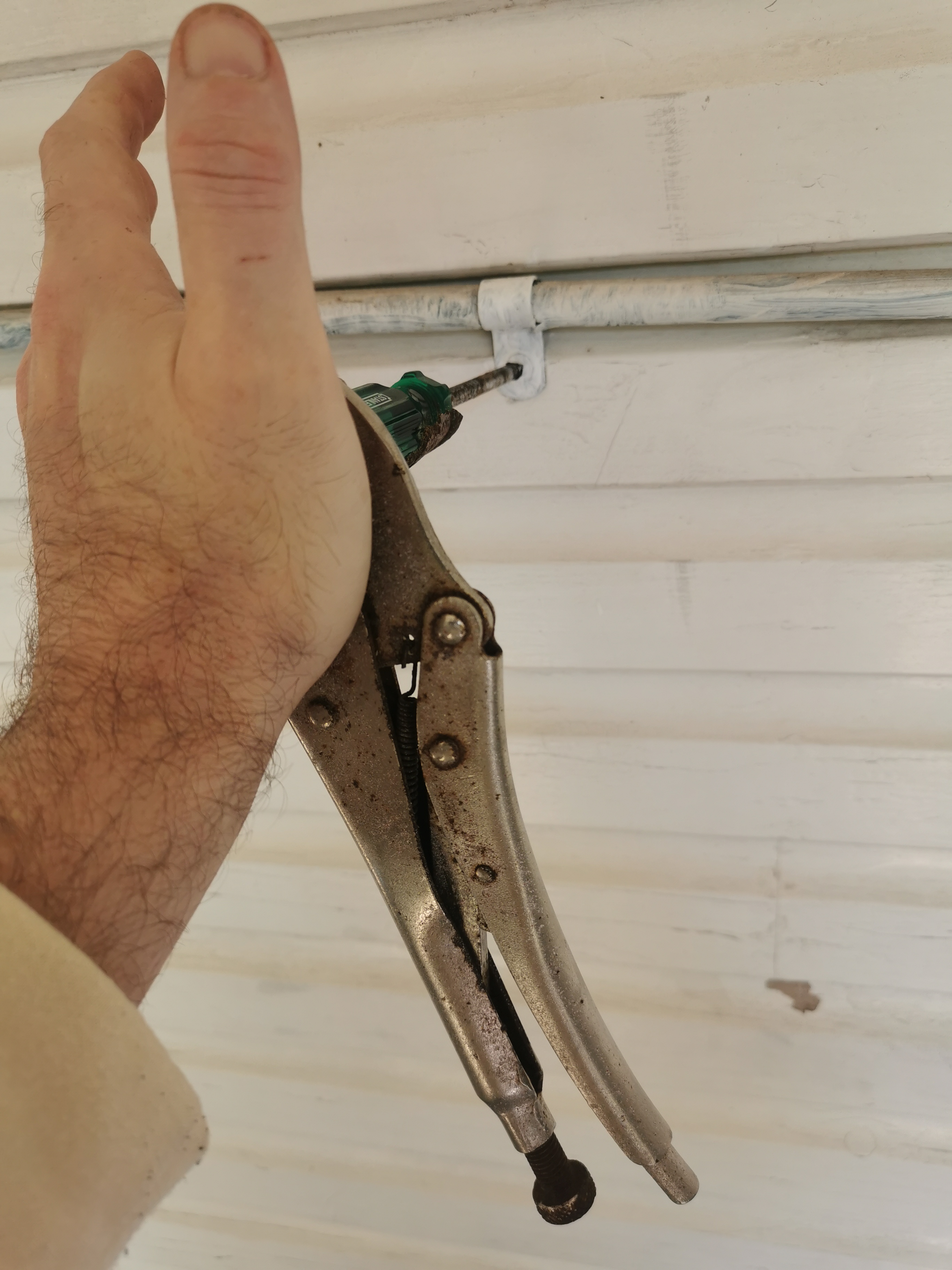

You might find that the heads of the screws are not proud enough from the mount to get a grip on with the locking pliers suggested above. However, here's a neat trick that's got me out of trouble numerous times before. Take the set of locking pliers and lock them onto the handle of a standard Phillips screw driver. This creates a lever handle which allows you to put an incredible amount of torque through the screw. Ensure you place one hand on the back of the screwdriver and push, to keep it firmly locked into the screw head and to prevent skipping. Now, turn the locking pliers slowly. I've never encountered a screw I couldn't remove in this fashion.

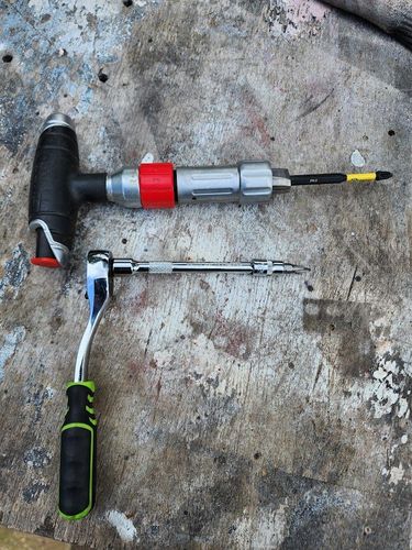

And expanding on @MitchellMc's idea - a ratchet T-Bar and/or a dedicated socket set with Phillips head sockets.
All about pressure and torque.
Otherwise - an impact driver.

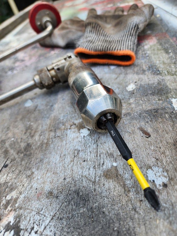

Then you'll just love a Bit and Brace with a 4-jaw chuck @MitchellMc 😃
Massive torque with pressure at the end.
The screw heads will either move - or snap.
