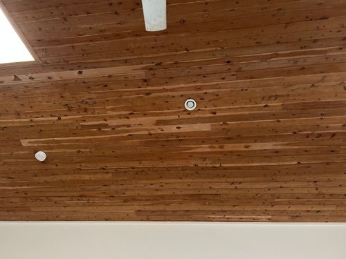

Is there any chance you could share a wider shot of the ceiling so our members have a better idea of what you're working with? If it’s the lighter board amongst the others that you’re referring to, it very much looks like the natural difference between sapwood and heartwood. You might like to coat the ceiling with something like a Scandinavian oil, which will help bring the original colours back out while sealing the timber’s surface. An application of oil is unlikely to encourage mould growth, but if moisture is entering the boards from the rear, that could still cause problems over time.

Thanks for your reply. The area of lightness on certain boards appears to be getting larger with time. I have taken a photo of a larger area of ceiling.

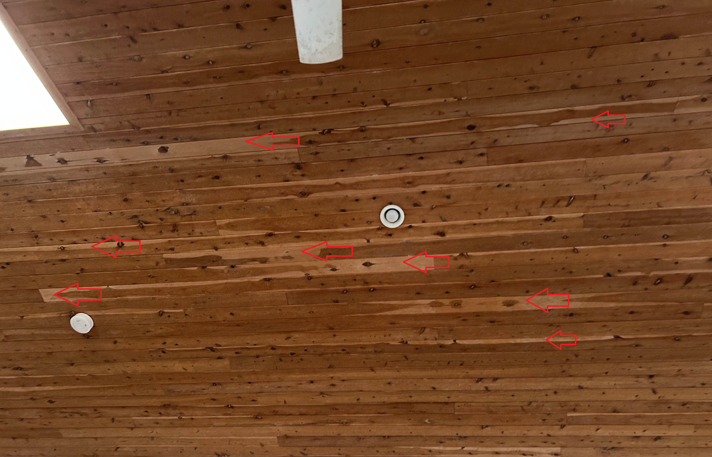

To clarify @Deb10, are we discussing the lighter coloured timber I've marked below, or are there other lighter patches that are not being picked up well in the photo? If there are lighter, dried-out patches, oiling would nourish them. If it's the lighter timber I've marked, that would be different parts of the tree, as seen often in Cypress pine, and it shouldn't be growing in size at all.

Yes, those are the patches I was talking about. They have become lighter and expanded with time.

As the natural oils have dried out over the years, they've likely whitened @Deb10. Coating with an oil darkens them slightly and adds a little honey-coloured hue to them. It won't return to the colour of the rest of the timber because it's sap versus hardwood. I'm not entirely sure why the lighter areas would be expanding, though.

As with @MitchellMc comments on how this has occurred. I would consider a very light clear coat, but maybe with a cedar tint just to those whitened areas. Allow 24hrs to fully dry and then apply another. Continue until you're happy that the variance is minimal. I have done this type of process with timber doors and decking etc where the exposer to the weather and directly sunlight has faded the timbers unevenly.
