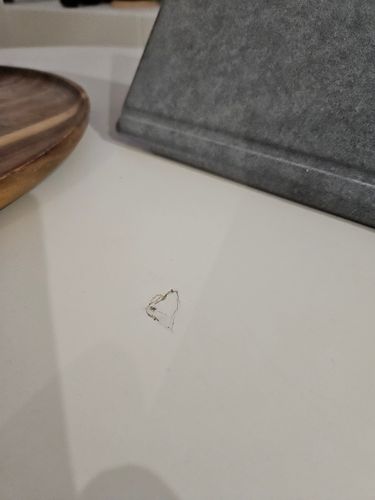

Any suggestions on how I could repair this dint in our concrete coffee table? Thanks!

You might like to consider contacting a professional who specialises in benchtop restorations and repair of chips and damage. They’d likely be able to achieve a seamless repair that blends in with the original finish and is virtually unnoticeable.
If you’d prefer to try a DIY approach, you could use a white two-part epoxy filler. Just be careful not to overfill the area, as epoxy can be difficult to sand back once cured. When sanding it flush with the surrounding surface, make sure to protect the rest of the tabletop to avoid scuffing. Keep in mind that since there are so many shades of white, the repair will likely end up a slightly different colour to the original finish, less noticeable than the damage, but still visible on close inspection.
