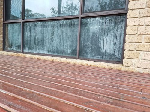

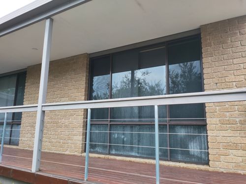

During the cold season my huge window glasses have condensation issues in the rooms.
Water is dripping and can cause molding issues on the wood.
Just wondering if there's any sealant or advice to address these issues

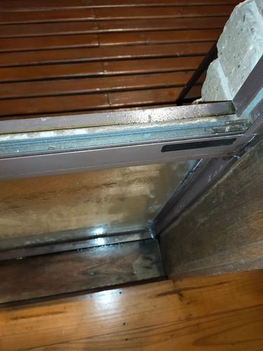

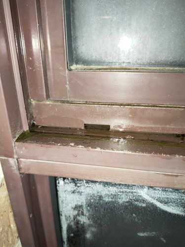

Mine are very old aluminium windows - but there is a channel that catches dripping condensation and releases it outside through small holes.
I know I have had your problem above - but it was due to the outlet holes being clogged up. Once un-clogged, problem solved.
But I can't quite make out the channel system in your photo above?
