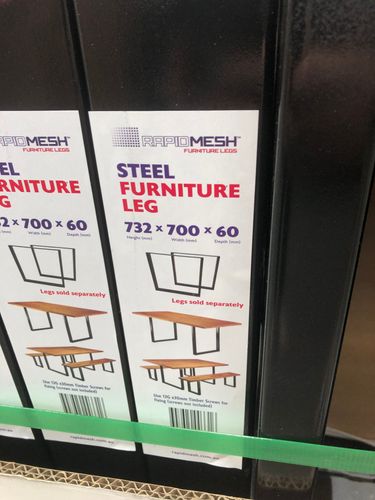

Bunnings have recently stocked these great steel industrial looking black metal legs. They went well with the solid Ash panel to make my son this study desk.

Many thanks for sharing your project and these fantastic legs you've found. I trust our members will be quite interested in this style of table leg as they look fantastic on your build. How long did it take you to assemble the desk?

I chose to leave the depth as 900mm, most might say this is too deep. My logic on this decision was to allow space for my son (8yo) to display a few bits and pieces without encroaching on the actual work area. His room is a reasonable size so the dimensions were not critical. The width is 1500mm and this was to allow for a nice 900mm x 900mm off cut which I plan to turn into and industrial style low line corner coffee table.
All in all this was a very simple project with only one cut, plenty of sanding and a bit of epoxy fill and a few screws. I used a non-toxic Cabot’s satin kitchen bench finish.

Thanks for the feedback. Yes the Ash table top was also purchased from Bunnings costing around $173.00. At the time I picked the clearest cleanest panel of Ash that was in stock. If I had my time on this project again, I'd most likely pick a panel with a bit more character which you could enhance with epoxy and dye and make a feature.
