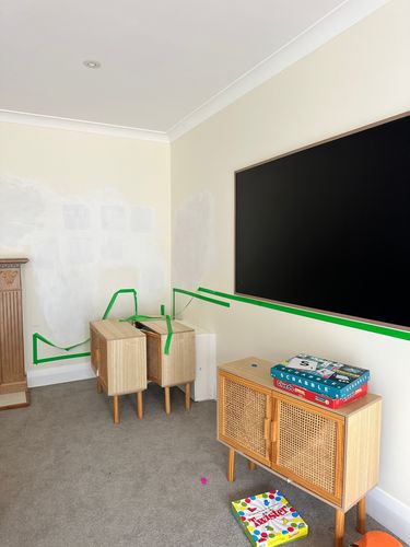

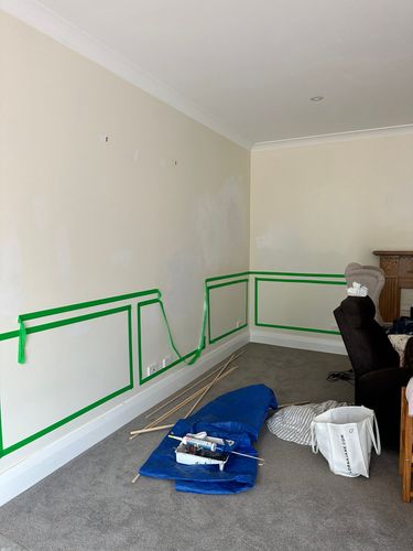

1. I drew a blueprint of the mouldings after measuring out the room. I then taped up the dimensions with masking tape to ensure I was happy with it
2. After selecting the bolection mouldings I used an angle saw to cut the required measurements
3. Using the wood glue and pasledo braider I attached this to the wall, then filled and sanded before caulking the edges.
4. Using resene paint in biscotti and 1/4 fossil I added them to resene white to create the saturation level that I was happy with before painstakingly hand painting on 2 coats to create a faux lime wash effect.

Re: Lounge makeover - light and dreamy
Thanks Jacob, the room before was very bland as you can see.
