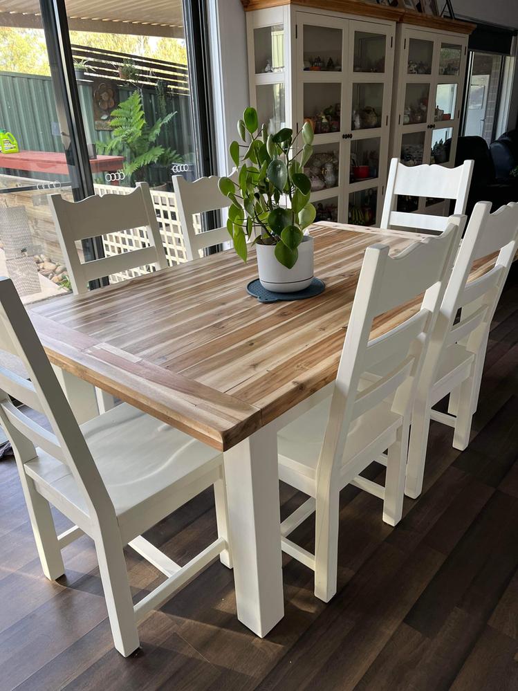

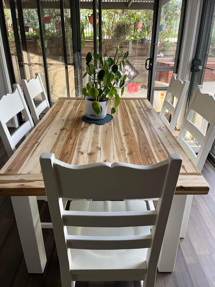

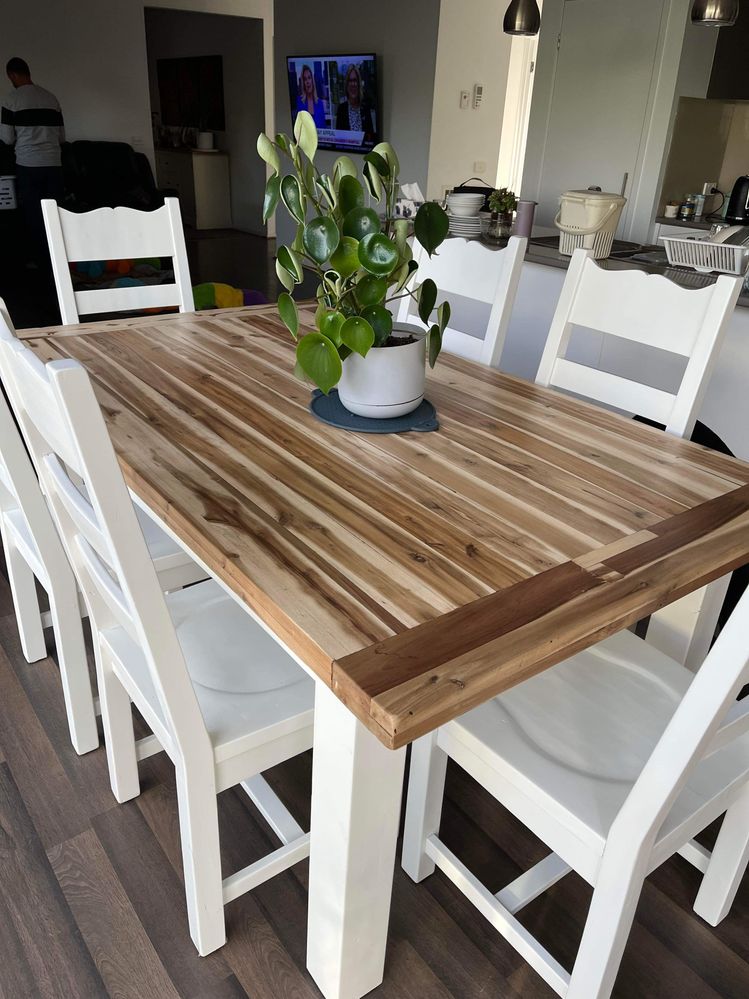

391DB440-0EA2-48CD-86D4-013011FCA8D3.jpeg315A5772-75AA-4209-8A13-DF80D794B7AD.jpegC370F395-C42A-49DA-AB4E-D74F967017F1.jpeg5A0C796C-A39F-4061-A9E1-94C8FE1FB773.jpegThis was an old and run down hard wood table and 8 chairs that needed a total makeover.
The top of the table was sanded back to raw wood revealing the lovely unusual wood grain. It was sealed with  two coats ofTimber protect satin finish clear varnish.
The rest of the table was sealed with two coats of BIN zinser to prevent bleed through and cause yellow staining, followed by three coats of Taubmans Milk Cloud just the prefect warm white and then all sealed with two coats of Timber protect satin clear varnish.
Each chair was slightly sanded to remove any peeling old varnish followed by tow coats of BIN zinzser and three coats of Milk cloud and lastly sealed with two coats of Timber Protect Clear Varnish.
