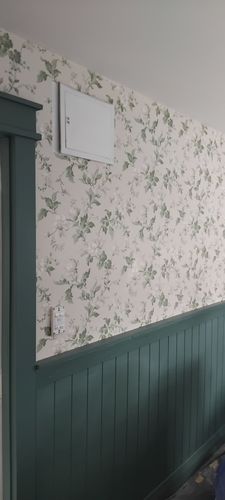

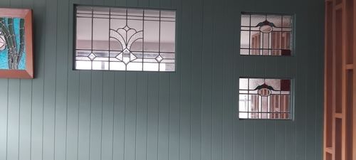

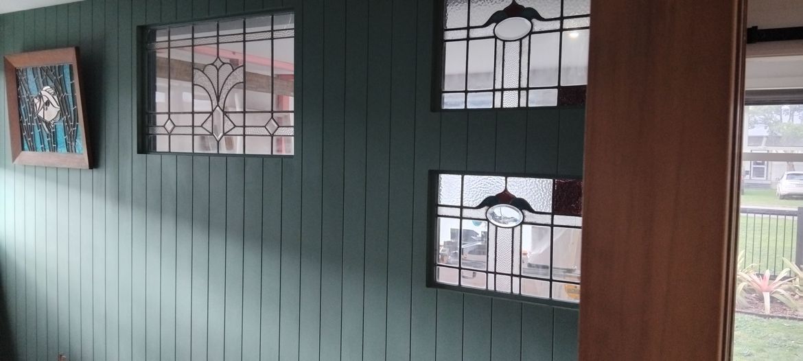

Framing went up as plans.
V groove MDF panels installed,window cutouts were next ,filled and sanded all nail,screw holes...then application of 4n1 sealer,primer,undercoat on MDF V panels.
next day windows installed filled nail holes,sanded...4n1sealer,primer and undercoat on windows..
When dry...painted 1 coat of green.
Skirting board added...holes filled and sanded,4n1 primer,sealer undercoat painted on...once dry 1 coat of green applied.
Next day...final coat on wall,windows,and skirting ...yah!!!
Hi @walkerkaiaua195,
Another particularly excellent project. Your home has such wonderful vintage glass.
The modern V-groove panelling, in the wonderful shade of green, is a fantastic finish to accentuate the beautiful windows.
Thank you for sharing another brilliant project and congratulations on all your hard work. It has definitely paid off.
Afternoon @walkerkaiaua195
Now that is an outside the box answer to allowing light in and also difusing it enough so it dosnt feel invasive!
Will be filing the idea away as I can see a few uses that it can be applied to. Love your window work btw!
