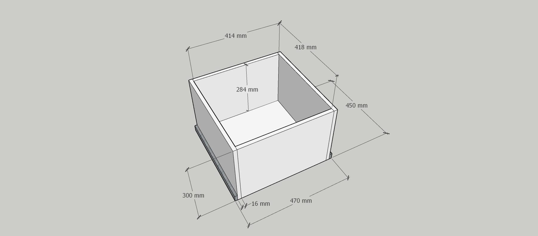

Re: How to install wardrobe drawer inserts?
Hello @NicoleT
@twocutekelpies raises a very good point about space left after the cabinet drawer has been built. I've done a quick sketch of the drawer itself using 16mm MDF panels. It will show you how much internal space will be left once the cabinet has been assembled.
