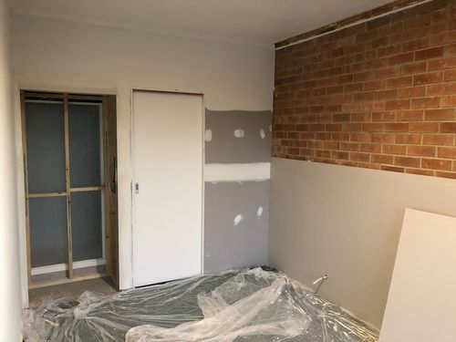

When lining brick walls with plasterboard, unless the wall is way off and needs battens to straighten sections, then simply glue the sheets straight over. A few photos below show my last home I did this to.

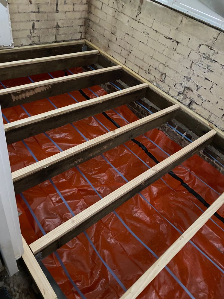

After fully removing all the rubbish, I put strong plastic on the ground and only ran it up the brick footing a little bit. Should I have extended it further to cover the footing or will this suffice?
