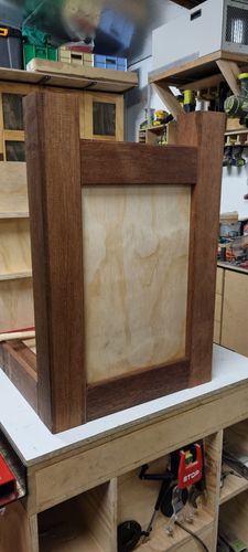

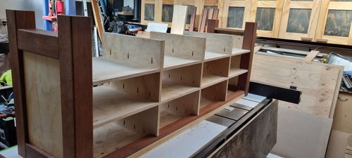

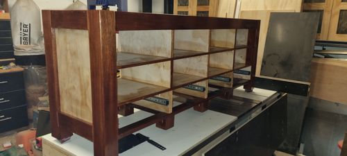

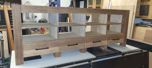

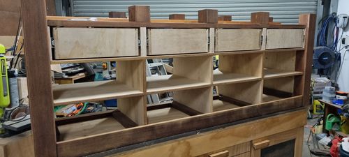

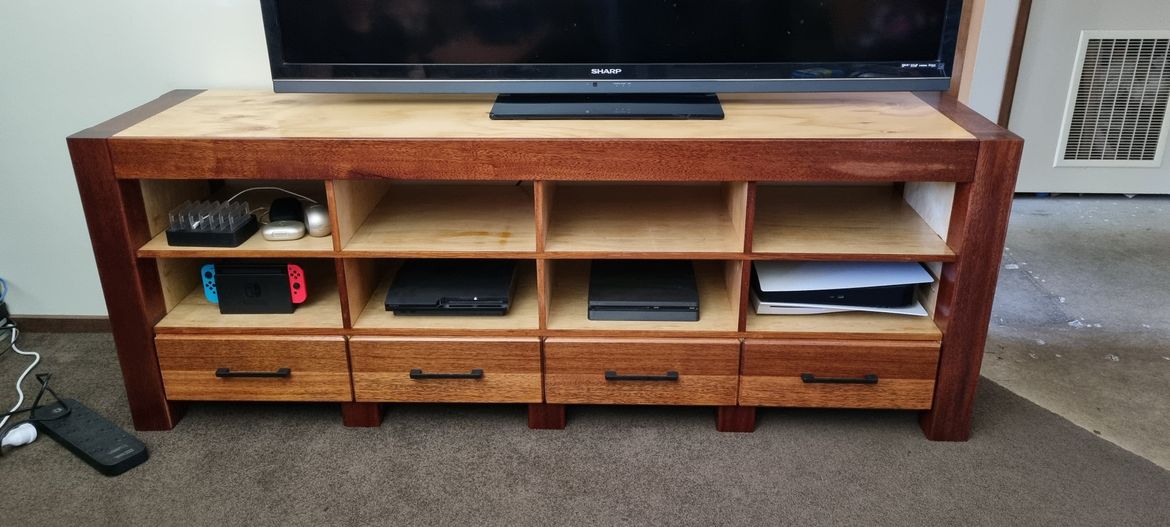

Here is our tv cabinet that I built. It is made from using merbau decking and 18mm ply. It 2000mm long, 500mm deep and 730mm high. I even made the legs by gluing a few pieces together, to make it solid. The top is 2 pieces of 18mm ply glued together. It's all been put together with some pocket hole screws. As an added feature, I ripped some decking down to some thin strip's and added them to the edge, just to hide the ply edge.

Re: TV cabinet using Merbau decking boards
Afternoon @Razzer
Love your entertainment unit, So many bits andpieces on it that stand out, from the ripped down merbau facing to the solid middle feet and the perfect cuts. :smile: No bowing in the middle here! That would be a nice addition to a lounge room.
How long did it take you to build?
Razzer
Having an Impact
Gday @Dave-1
Thanks for that.
It only took me 2 weekends to build. A table saw makes building stuff quicker and easier. I've also used merbau to support the top aswell. Over killed it haha
With young kids around, I wanted to be strong and still be used many years from now.
