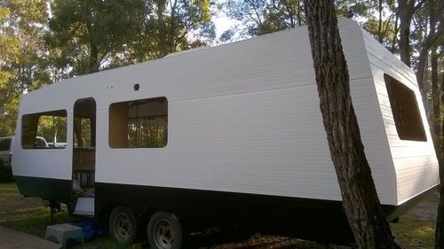

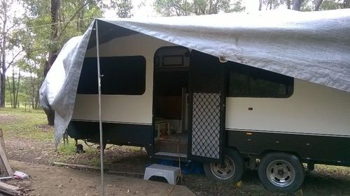

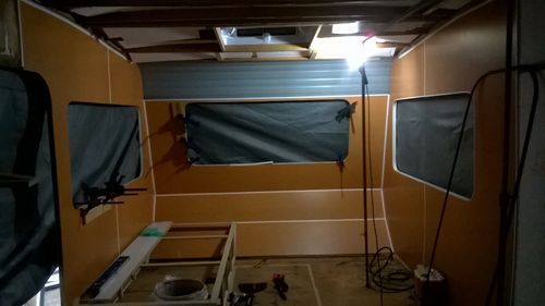

I have responded on your original post 😊  Don't be discouraged by no undercover area, my first caravan reno was a 23ft Viscount (also sandwich panel construction) and all I had was a giant tarp and caravan cover. Thankfully we were in a high block house so I had a work area under it to cut up all my panels etc.
