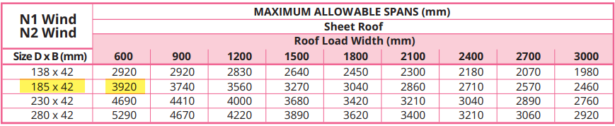

As the roof structure is not supporting the roofing material, I can't find definitive information on spans, but using these Woodhouse Span Tables as reference, when supporting a sheet roof with rafters spaced 600mm apart, an F7 rated 185x42mm timber can span 3920mm.
Considering there is no roofing material to support, a timber of a similar size, such as this 190 x 45mm Outdoor Framing H3 Treated Pine would be what I would look at.
If you wanted a more refined finish, then I would also consider the 185 x 42mm F7 H3 Treated Pine Primed LOSP, but it will be at an increased cost compared to rougher H3 framing.
