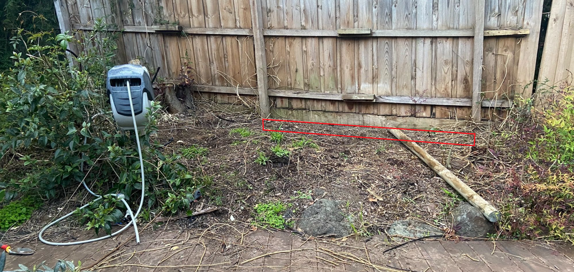

The Area
This is the garden bed up against the fence. It used to have this weird lean to structure that housed a bunch of shade plants. You can see the bed sits a little above the current deck, and I'm happy for the proposed deck to sit a 'step up' above the current deck. Note, I will be relocating that hose/tap currently in place.

Well its been a weekend of digging out a massive amount of soil to level the area! Love the ideas above. Whilst I would love to do a concrete slab, I do plan on moving the sauna in the longer term, say 3-5 years when we complete further landscaping in our backyard (still have pool dreams!). Great idea on string line, I will get this measured up and post some photos of what we are working with.

  • Remove 50mm of soil from your desired finish height and level the area using a string line and line level. Since you're planning on using a string line to mark the site, you can use this as your reference point. Once you have your level perimeter line, measure down to check your depth and that the excavated area is also level.
  • Around the perimeter of the area, dig a 50mm wide trench that is 150mm deep. Digging it slightly wider is OK, as you'll be backfilling later. The depth is the main requirement.
  • To ensure you don't experience any subsidence issues in the future, I'd suggest running over the soil to ensure it's compacted and level. You can hire a compactor for 4 hours, which should be plenty of time for this small area.
  • Lay Geo-Textile fabric over the area to aid drainage and prevent weeds from growing up from the soil and through your pebbles.
  • To fill the area, you could do a 30mm layer of sand and compact it before filling the remaining height with your crushed rock. Or, just fill the 50mm with your crushed rock. I've seen this model sauna placed on un-compacted soil, so the additional sand and compaction layer might not be necessary. For your medium, the larger the stone size, the better the drainage quality. I'd encourage you to check out our range of bulk-delivered products as they'll work out far more budget-friendly than smaller bags. We can also order feature boulders and larger rocks for landscaping around the sauna through our supplier, ANL.
If you start to undermine the fence, you can affix a treated pine sleeper between the two upright posts with Climacoat Bugle Screws. This additional sleeper would be placed directly below the current one.
