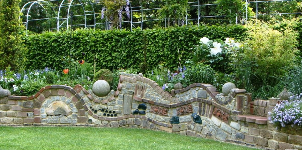

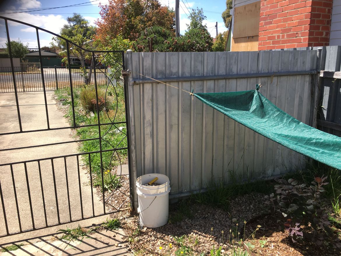

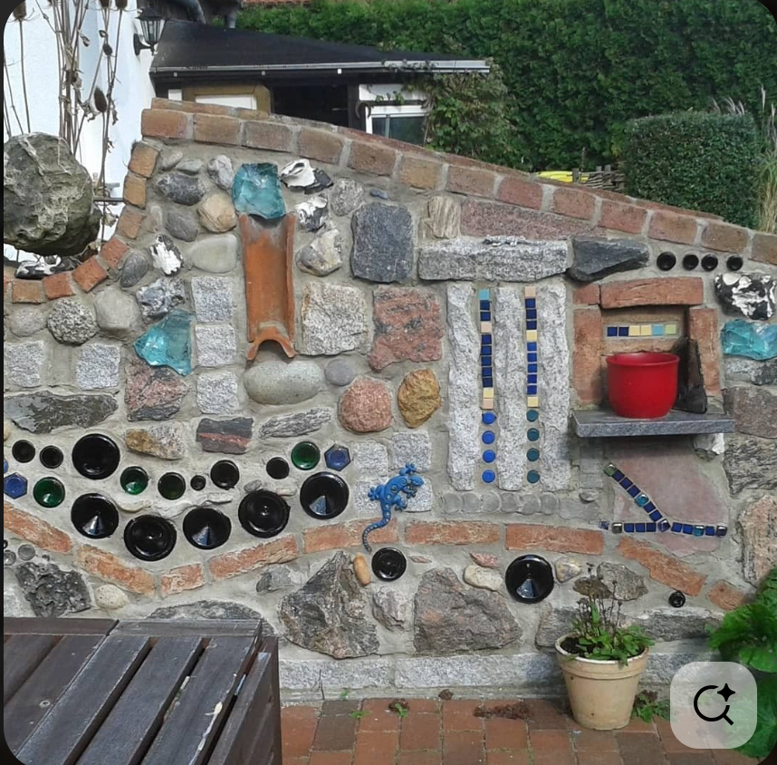

Hi, I'm looking to convert a metal sheeting fence into a mixed material garden wall from upcycled materials such as stone, bottles, cement etc. The aim is to have a unique look that also allows places for fauna and flora to hang out. It would be about 1.5 meters tall. There is a gate that is supported by the metal posts the wall is made from... I'm hoping to keep the gate and the posts but simply remove the metal sheeting and replace it with stone etc. Is this possible or would movement from the gate flow through into the posts and ruin the stability of the wall?
many thanks. Screen Shot 2026-02-02 at 11.22.12 am.pngScreen Shot 2026-02-02 at 11.24.26 am.pngIMG_1765.JPGIMG_1766.JPG

You are correct that the movement of the gate and the force transferred into it would likely have an effect on your wall, so my suggestion would be to remove the metal sheeting and horizontal rail, then leave the post in place and build your mixed material wall up to it, but keep it separate.
Keeping the posts separate from the mixed material wall will mean the force is isolated and will not transfer into and through the wall.
