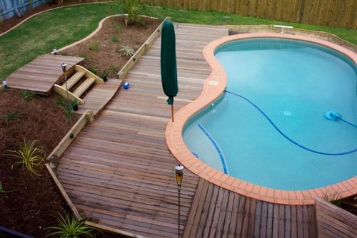

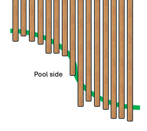

Jigsaw used to cut curved deck endsJigsaw used to cut curved deck ends
Screenshot 2024-10-04 at 7.22.46 AM.pngScreenshot 2024-10-04 at 7.22.56 AM.png

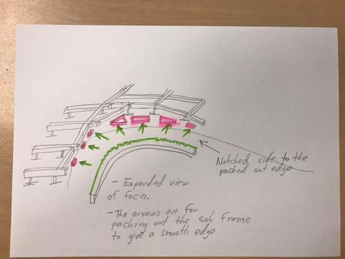

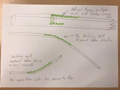

So the post was on Page 7 of this thread just before your photos I give a description on how you could make a bendy piece of facia.
I will attach a pic on the idea, just need to sketch it first :smile:
The highlighted green segmants are notches you would create in your facia board, pretty much set your circular saw to half the thickness of the facia board and do a bunch of cuts next to each other. So cut, space of a cut, then cut again. No need to measure, just work your way along the board. Over the area that requires the bend.
This is what I mean by padding out your frames to make it easier to have your facia board bending. The idea is to smooth all the deep parts of a bend so its more "even" and that way less strain on a board.

This is awesome Dave, and so detailed. Thank you. The composite decking does seem really tough to bend but I guess with cuts like you say it will buckle in easier. Im not that experienced with the circular saw, I actually borrowed a large one (the kind that isn't so portable as the hand held ones) and I can explore how to do it, so you are saying just cut half way into the deck board and that part you need to bend will go eaiser?

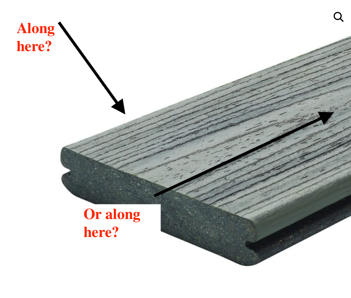

Re: Update on Decking Project & Question
Afternoon @ricm
Across the width of the boards. You will have to adjust the height of the blade to the saws foot so it cant cut deeper :smile: Dont try to do it by eyesight lol I have done so and ended up with a bunch of smalle pieces.
