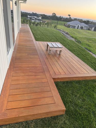

Hi I’m planning to build a wooden paragola for the outdoor deck. PFA a photo of the deck for reference and a photo of what I have in mind to build. Would like to know what size of pillars should I use and what would the ideal wood be for the purpose. Would like to have a hammock placed as well in between the pillars so would like the pillars to be able to take the weight. Any suggestions will greatly be appreciated.

Hi Eric as long as the Pergola’s less than 30sqm an approval isn’t required. Mine is probably gonna be appx 1.5x3.6 only on the protruding part in the deck where you can see the table kept. In my opinion too small a project to involve a draftsman. Any suggestions will be greatly appreciated.

Good Morning @KSB
I like 90mm by 90mm posts, with headers notched across the top. 120mm headers at least. I am not a fan of attaching a pergolla to the house as I think they should be freestanding. (I figure they should be able to stand up under their own weight/structure)
Figuring the fall of the roof is something I would make sure of, also the height from the deck at the lowest point (to the roof) as it will show if its possible to attach it to the side of your house.
Your trusses/beams are short, so you shouldnt have a problem with the height. As to the hanging a hamock off the structure. This I would add more stays to help stop lateral movement, A body swings with a resonable momentum so you wanty it to be able to handle that.
