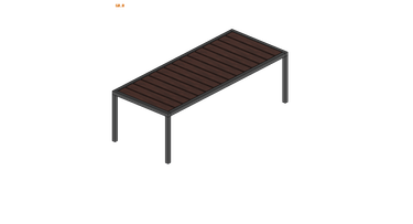

I'm thinking of using 50x50 pool fencing for the legs, cut down to about 700mm height, capped off on the bottom so not to damage the flooring. Looking to make up a rectangular frame with steel to sit atop the legs. 2400mm long with 2 inner rails spanning the same distance with a couple of cross pieces to stiffen it up.
Currently thinking of using left over ekodeck boards I have from the deck project to act as a table top / inlay. The looking im going for is a butt joint "picture frame" using the steel framing with the ekodeck boards inlayed and to finish flush along the top with the frame

current proposed plan attached

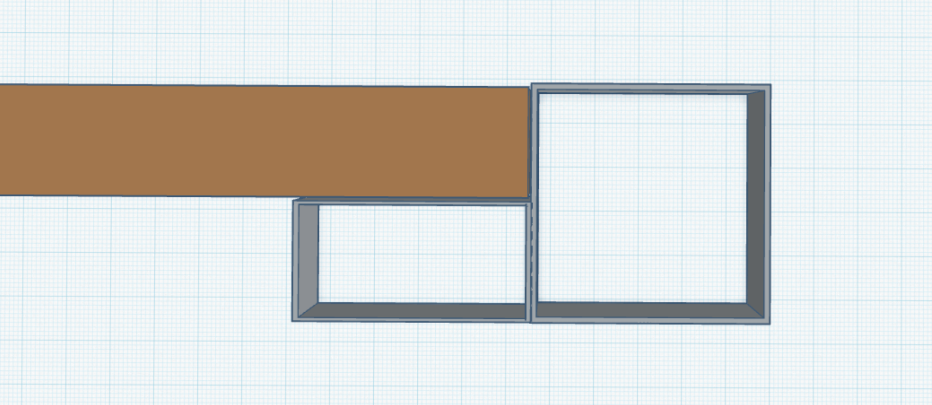

I'm thinking that because ill be running the boards width ways along the table top that I need to have some sort of "lip" along the inside of the outter rails so that the boards have something to rest on, do you think that this is necessary? to give it enough depth ill use the outter frame with 50x50 and use 25x50mm for the two inner rails. I believe the ekodeck boards are 23mm so with some minor adjustments I believe I can achieve that "flush" look

Also could you have a look at the attached images and see if where my proposed cross supports are in a good spot?

I'd weld a 25 x 50mm to the side of the 50 x 50mm section @Halima. That way, you have a nice lip for the ends of the boards to sit on. I believe the 50 x 50mm will be strong enough for the legs, provided that they are attached well. Sketches look great.
