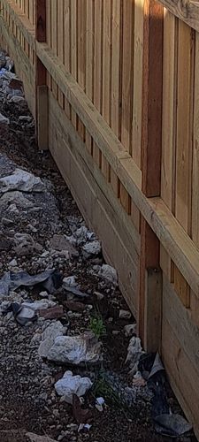

Hi @Jas1983 , looking at your pic, the depth looks more like 200mm (perhaps185mm?). 85cm is almost a metre deep. If you wish to prevent weeds and save on the amount of pebbles needed you could either put down weedmat, then bluemetal (cheaper than pebbles), then cover that with a good layer (at least 50mm) of pebbles to make it look better. Otherwise, build up the channel with clean yellow or white sand, followed by weedmat, then a layer of  pebbles . Best not to use garden soil to fill up the gap as this will allow weeds to grow.

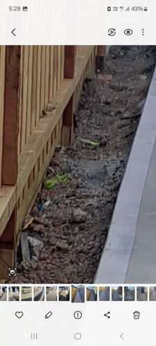

 thanks for reply. Already put sleeper . You can check in photos do I need to do anything with fence. Or just put weedmat, bluemetal and pebble. Will it stop washout underneath concrete.  Ta

Do I also need put aggy pipe for water drainage. Or just put weed mat, blue stone or sand and pebbles. Thanks

I agree with @EricL . That width of path is very unlikely to collect more water than the side channel will cope with through natural drainage. Which way does the land slope? If the runoff heads towards the far end (in your pics) opening, then water on the path and in the side channel will head that way too. Unless there is a heap of rain water entering the pathway from  another source then you should be ok with it just running into the stones and soaking into the ground.
