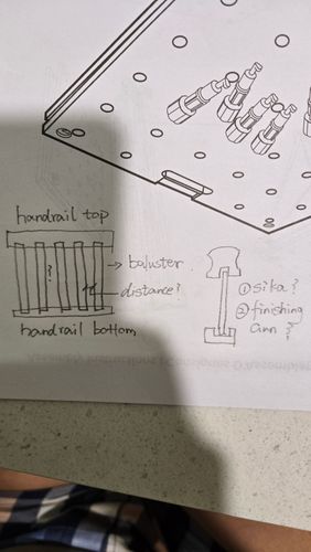

If I use the material below as baluster
How should I fix it to the top and bottom handrail?
Use sika flex or finishing gun?
And what is the distance of each baluster?

Re: How to fix timber handrail to timber post
Hello @vincehuang
I suggest checking your local council's rules and regulations in regards to handrail and baluster construction. I'm quite sure that they will have the necessary information in regards to the height and spacing of the balusters. In regards to its fixings the balusters should be securely attached to both the stair rail and steps using strong mechanical fixings, such as screws or brackets, to ensure structural stability. Using just glue or nails might not be enough to hold the baluster in place.
