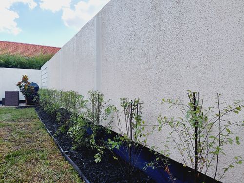

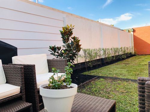

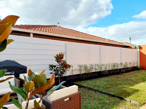

Finally completed the weatherboard and FC sheet fencing project. We also laid some turf which should hopefully settle in well.

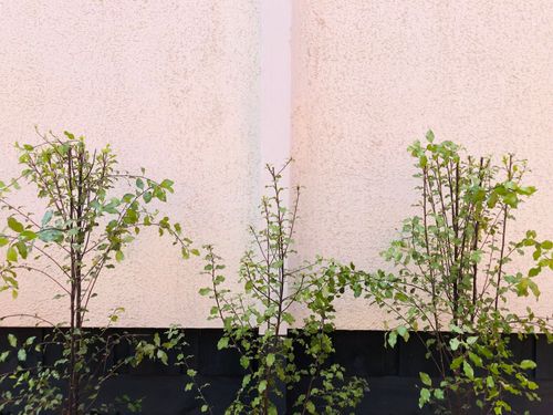

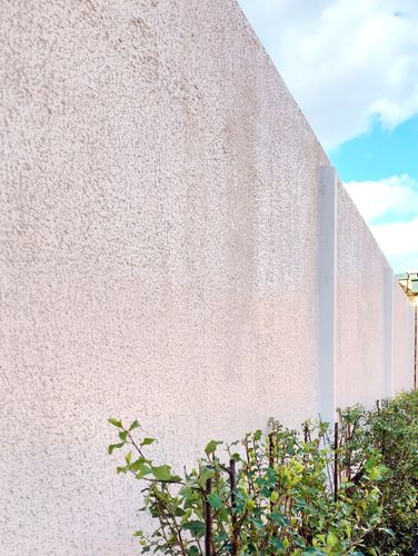

Here are some snaps from over the weekend when we applied the textured coat to the FC panels.

That has certainly come up so nicely! Especialy from what it was to what you have now!
That is a vast improvement! It streamlines your yard and makes it your own. As usual you have made me think about one of my side fence areas and how I want to makethe fence higher. I think paneling it like you have might be the way to go. I have had that thought many times "biting off more then I can chew" and each time I tell myself to breath and break it down to smaller steps. It dosnt look like you were outa your depth ![]()
Sensational work, @diy_hausdesigns! You've created a stunning fence and should be very proud of your achievement. You've done a superb job.
I'll be looking forward to seeing your deck incorporated into the area. Please reach out if you need any assistance.

This has been such a useful thread @diy_hausdesigns!! Thanks. What did you use for the texture on the fc cladding sheets? And do you remember how thick the fc sheets were?

I used the Dunlop product in surfmist colour and the FC was 7mm if my memory serves me correctly.
I recommend a bit of patience with the render paint and just getting the right application too.

Thanks for this..both of these products require a float/ trowel application. Is there any other texture based product that can just be rolled on? The texture paint says rolling on is fine but then needs finishing by trowel.
I have some experience with rendering but I have a big area to cover and would like a quicker approach. Any suggestions? Thanks.
Hi @WingingIt
I used a roller specifically for textured paint instead of those options for the same reasons.. easier
https://www.bunnings.com.au/uni-pro-230mm-medium-foam-texture-roller-cover_p1660574
It was a bit messy but once I had the hang on it, it went well.
