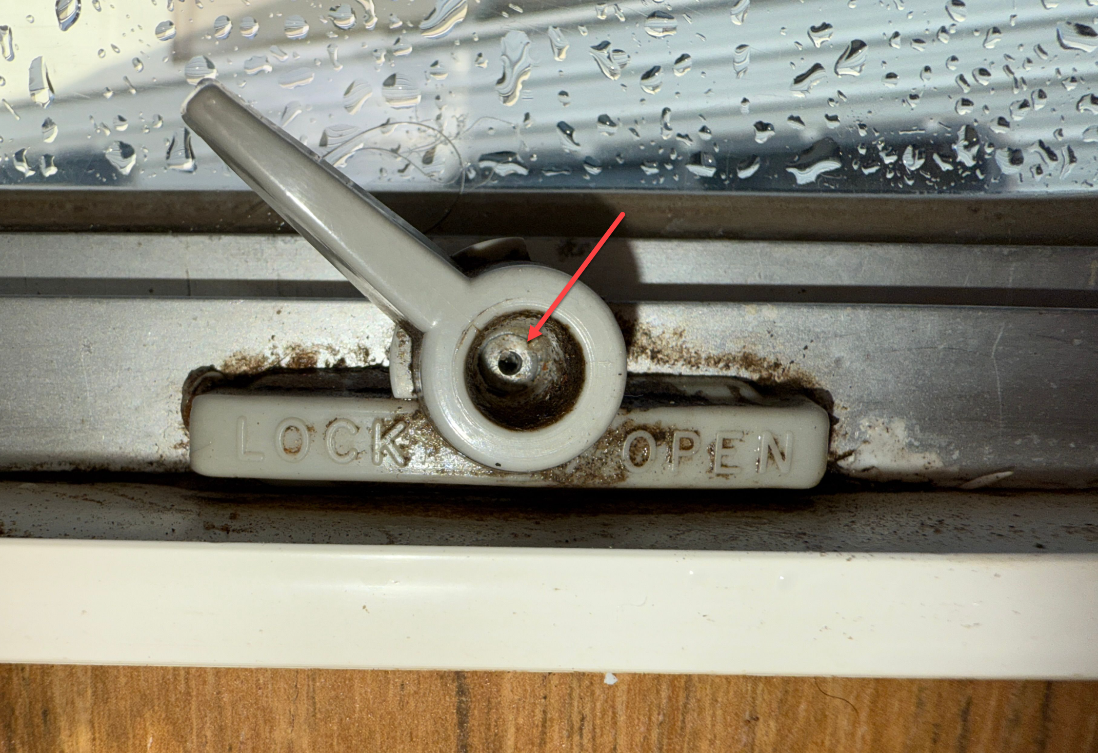

Would it be possible for you to post a photo of the other side of the window lock. I suspect it is an aluminium pressed post and might need to be cut instead of drilled out. Once the other members see the other side of it well be able to assess if it is a giant rivet.

 Hi @EricL this is the inside…I’ve not got drill happy as yet…will await your advice!

Hi @CrikeyCoral,
You can see down the centre of the handle the other side of the rivet.
I would drill from the inside out, so you can see the handle itself, which is the thing you won't want to damage.
Just keep it steady, make sure you start slow and don't press too hard, let the drill do the work. Once the drill bit starts to bite, you won't have any issues.
Let me know how you go.
