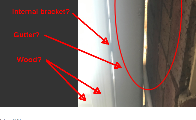

After a bit of rain last night I noticed quite a bit of water coming in via the gap between the house and the pergola guttering.
Any recommendations on how to go about sealing this? or what products I should use?

Sorry gents.. see photo attached
My eyes aren't good. A gutter close to a brick wall?
Hi @AdamK1 thanks for the photo.
That's really not a good install. In heavy rain or if gutters are blocked or have gutter-guard fitted then you will get overflow or over-splash. Impossible to avoid with the current configuration.
Custom flashing added between the gutter edge & house would reduce some of the problem but that won't fix the problem with overflowing in heavy rain.
Was that professionally installed or a DIY job?
Not too sure if professional or DIY - Only moved into the place a month ago and then last night discovered this..

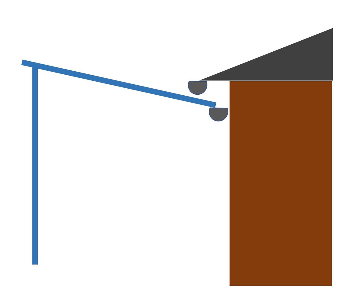

Okay, very rough diagram but I'm assuming your roof lines look a little like this?
Correct!
