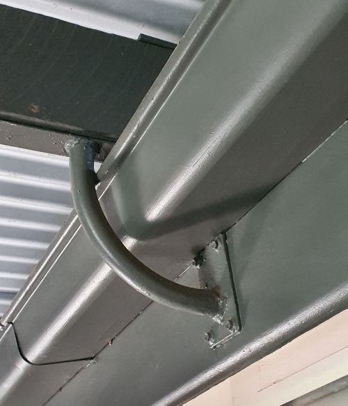

Long time reader, first time poster.
After a bit of rain last night I noticed quite a bit of water coming in via the gap between the house and the pergola guttering.
Any recommendations on how to go about sealing this? or what products I should use?
Any advice would be greatly appreciated.
Cheers.

Hello @AdamK1
Thank you for posting those photos. Let's talk about some of the symptoms of this type of setup. Are you getting dribbles of water coming down the wall or is it just the occasional water splash? Is the roof overflowing into the Gazebos gutter? In these instances, we can try some standard troubleshooting steps.
  • Perhaps the gutter needs a clean? If it has just been serviced odds are your downspouts are not coping with the volume of water being produced by your roof. Perhaps one of them is blocked?
  • Perhaps there is a blockage on the Gazebos downspout.
  • Another possible cause is the angle of the roof of the Gazebo is too steep and is causing the water to bypass the gutter.
If it is just splash-related wetness and not a water overflow issue you can cover the gap from the top with a Galvanized window flashing. I've placed a diagram below for you to see.
If you have any questions, please let us know.

Thanks for an excellent image there @EricL, just what I had in mind when I mentioned flashing earlier. Just looking and the style you'd want is technically apron rather than angle. You can have these custome made in a size to suit.
As @Noyade pointed out the ideal structure for such a situation is for the additional roof to be above, not below the existing roofline but that then poses it's own issues as you generally have roof mounting involved etc.
There's also an excellent bitumen impregnated foam expansion tape that is fantastic for waterproofing such situations, I've used it to fix a roof valley gutter leak. Can't find it on-line but if I can I'll link to it for you.

We can order custom made angles using the clock method from Fielders. Their type 44 or the angle I've put together on the right could be suitable.
The bitumen impregnated foam is Compriband from Ormonoid. I know Abelflex, which is just the foam, has a sticky back version. I'm not sure whether Ormonoid makes a sticky back bitumen impregnated one, or perhaps it's a different supplier. It sounds like the bee's knees though and would be ideal if you can compress it between the guttering/flashing and the wall.
