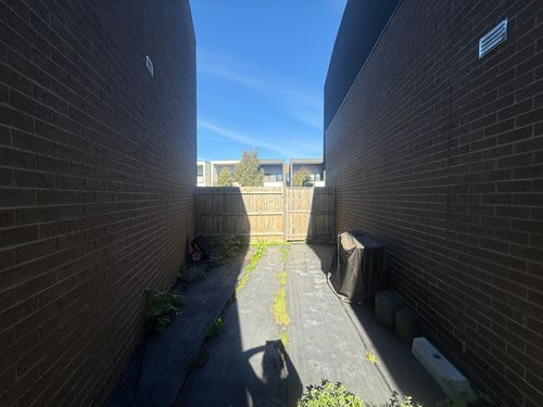

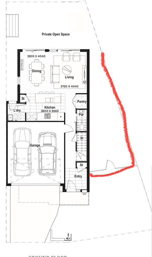

I have an almost triangular shape side yard in between mine and neighbour’s wall that I hope to make it a functional area. The fence area on the right is the entry door from the front. Size is around 35m2.
Since this will be my own project and we are not quite a handyman, what will be the easiest thing to do ? I personally love gravels/pebbles and maybe some pavement for outdoor seats . Do I have to leave some gap on the side for rain water drainage ?

First, you already have weed matting laid down, which is a good start, but some weeds are still poking through. A quick step would be to tidy this up by pulling the larger weeds and adding a fresh layer of weed mat or thickening the existing coverage. This will give you a clean base to work with and reduce future maintenance.
For surfacing, gravel or pebbles are an excellent low-effort choice. They are affordable, easy to spread, and suit narrow spaces like this. To keep them in place and avoid mixing with soil, consider installing some simple garden edging along the walls or central path. You can also mix gravel with large stepping pavers to create a more stable walking path or a small seating area near the gate end. This gives you a structured yet natural look without requiring complex groundwork.
Drainage is important in a space like this because the two walls create a kind of channel for rainwater. You do not need to leave a large gap against the walls, but it is smart to ensure that the ground slopes slightly away from the house walls. You could leave a slim strip of bare soil or drainage stones along the edges, so water has somewhere to run. If water tends to pool here, a strip of coarse drainage gravel or a channel drain near the fence end could help guide runoff.
For functionality, a small bench or a couple of outdoor chairs at the wider end by the gate would work nicely. Since the area is enclosed, adding vertical features like slim planter boxes, climbers, or wall-hung pots on the fence could also break up the narrow feel without taking up much floor space. I suggest having a look at our Top 10 most popular backyard projects and D.I.Y. fire pit ideas for starters. Our Featured Projects section also has many more ideas you can explore.

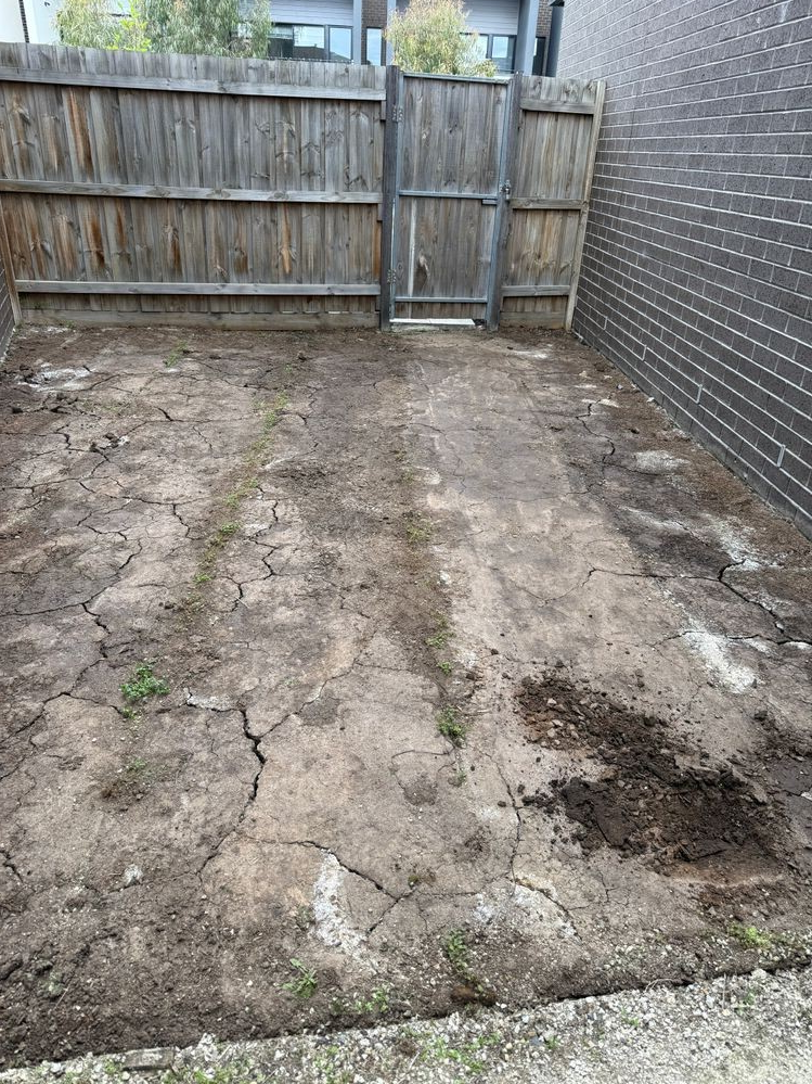

Hope everyone is enjoying the long weekend ! We've done some clean up this weekend as a start and have some additional questions, hope to have further guidance :
1) Given the current condition of the soil area near the side gate, do I still need to dig deeper before laying down mat ? I'm thinking geotextile for better drainage.

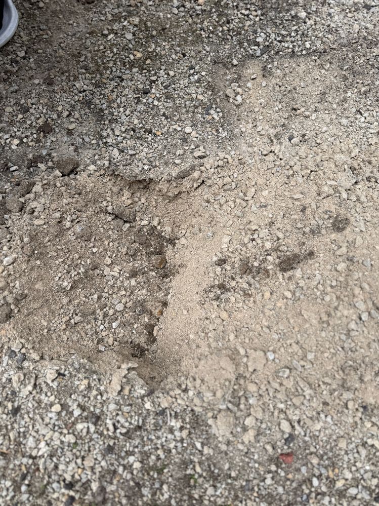

2) The narrower part of the yard are mostly sandstone as per photo below and they are more elevated than the soil part. I'm thinking to move the excessive sand to the soil area. Would that work or I need specific type of sand before laying down the gravels ? Appreciate if you can provide a step by step guide.
3) Do I need to glue down the gravels or tampering will be sufficient?
Thanks in advance!
