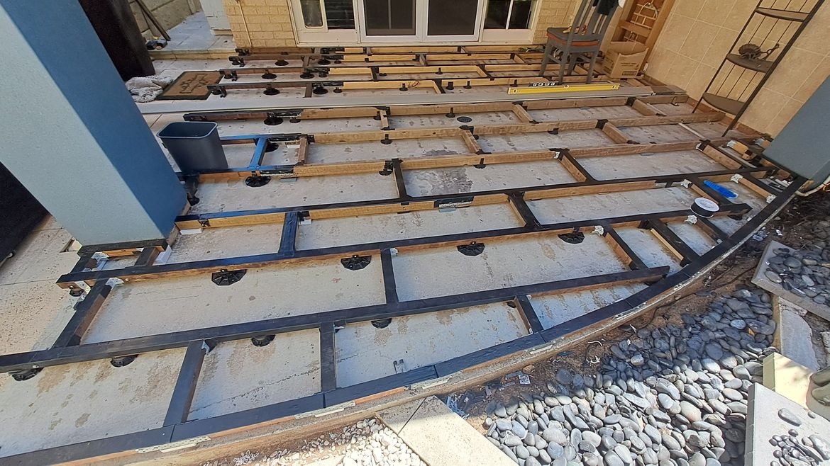

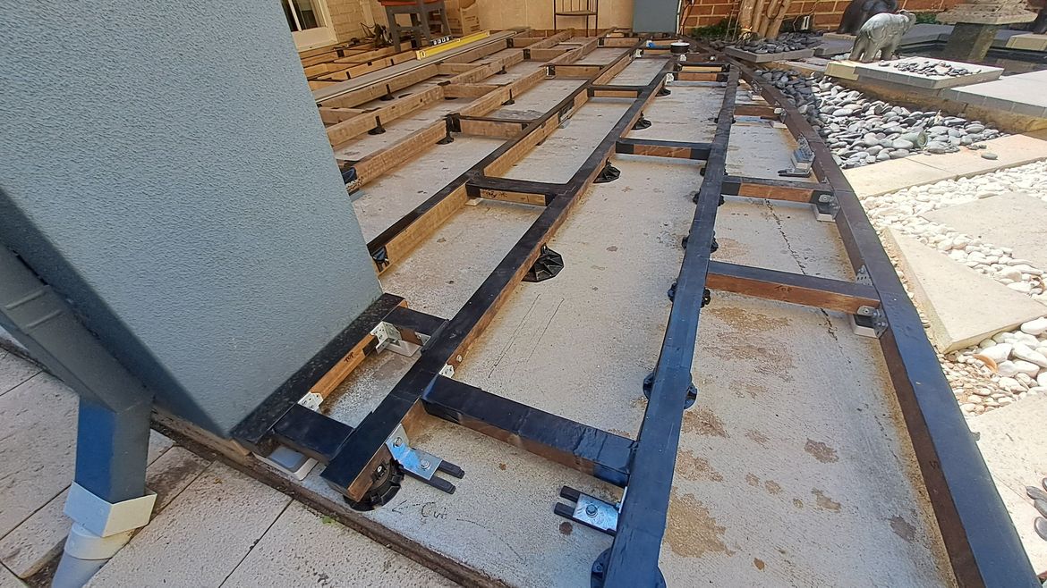

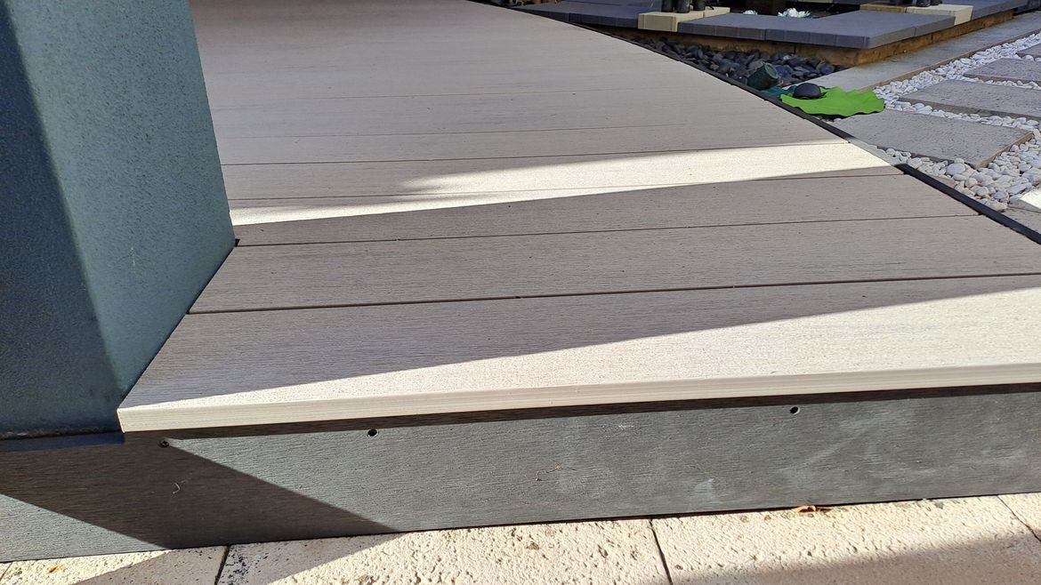

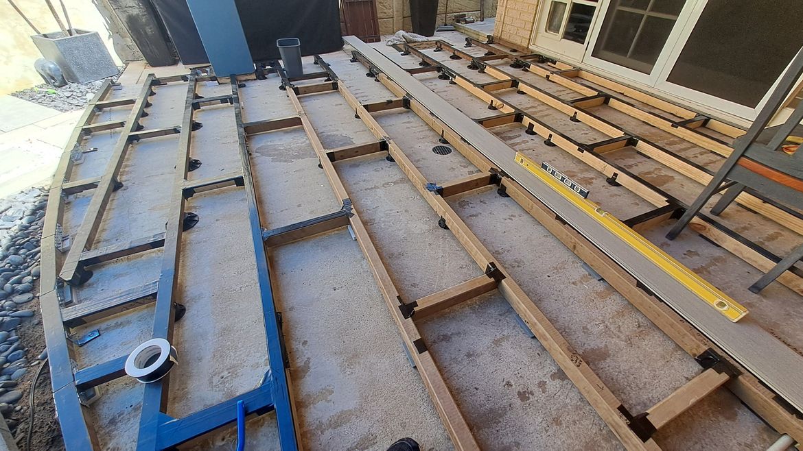

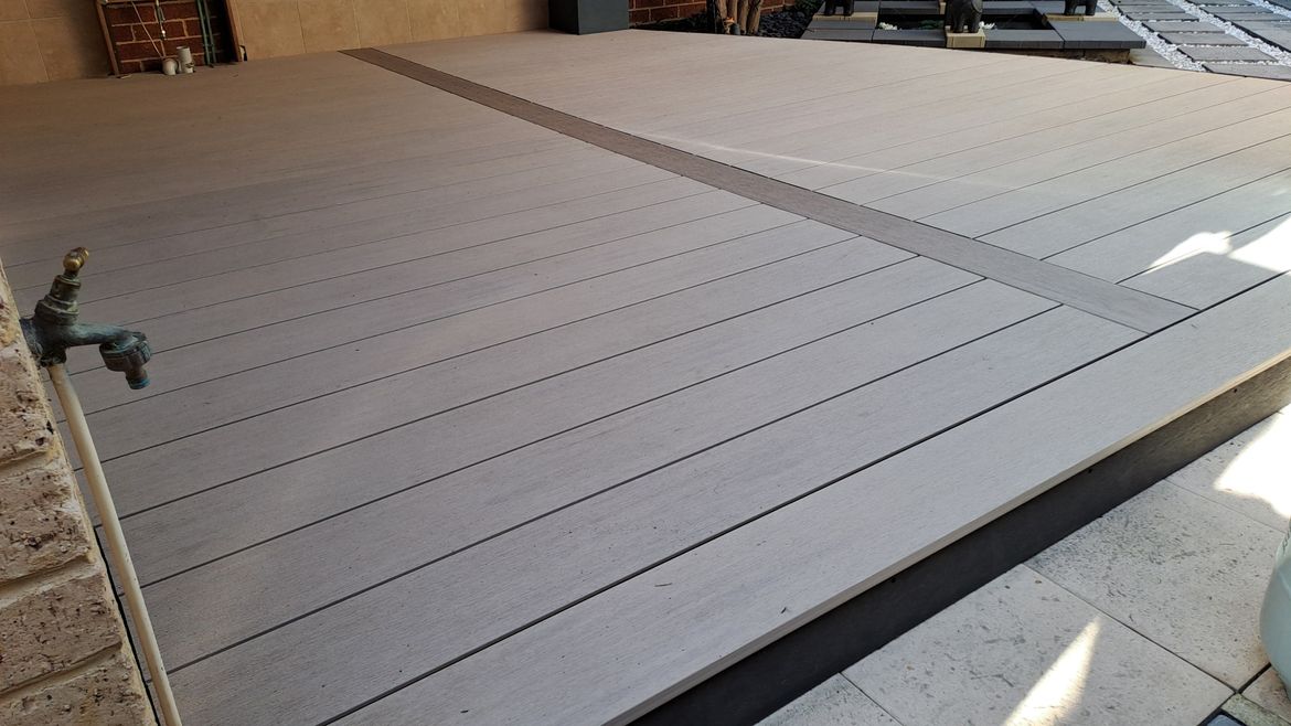

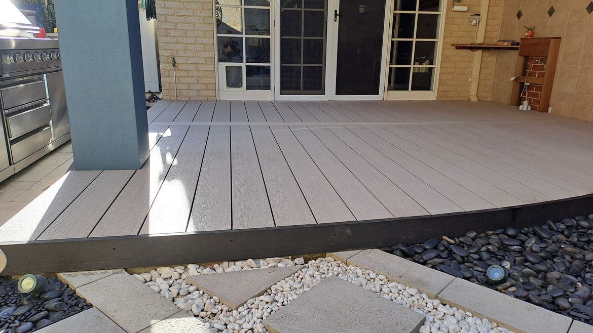

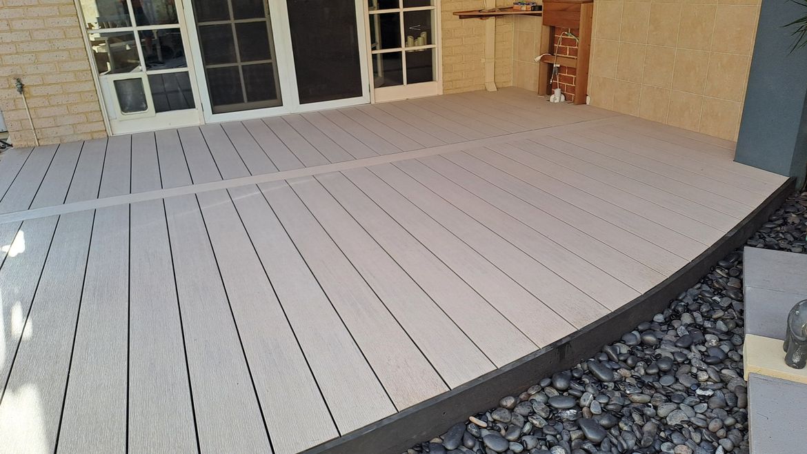

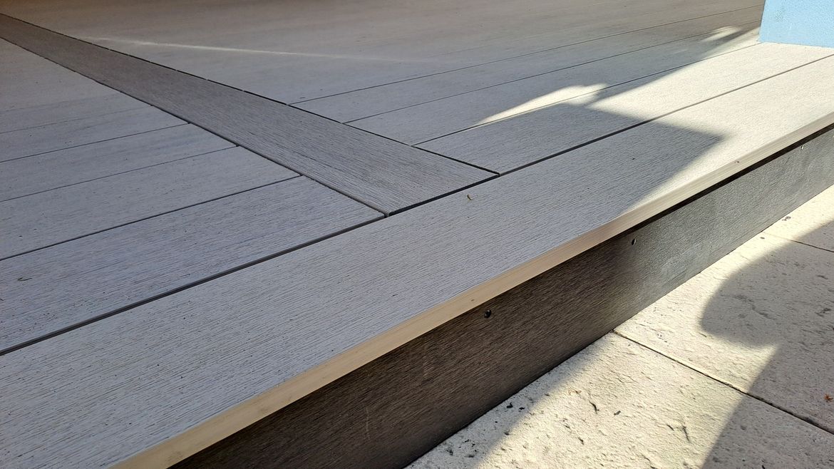

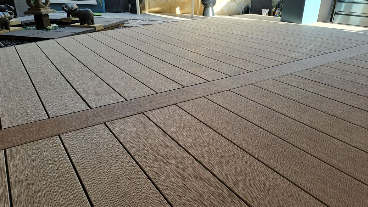

Thank you all for your help. I finally finished the project.
Summit 'Fairhaven' boards with Classic greystone fascia boards.
I went with a breaker board for a couple of reasons. One was reduced wastage and cost, notwithstanding much more time on the job. I saved around $300 by being able to plan the best cuts to maximise the 5.4m lengths. The second reason was the previous deck substructure in the outer area was quite rotted. When that happens again, I might be able to just pull off the composite in the outer area, fix the substructure then put the composite back.
Some pics.

Re: Is Bunnings 42mm x 42mm Merbau suitable for joists for low level decking?
That looks fantastic @Henry1 and looking at the support structure, I imagine it is dead sturdy.
The decision to use a breaker board was certainly worthwhile considering the cost reduction.
I can't say I'd seen the Fairhaven / Stirling Summit Series Composite Decking on a deck before now, but I am really loving the look. It looks lovely and bright and creates a really welcoming space.
I hope you are extremely proud of what you've achieved.
Thank you for sharing.
