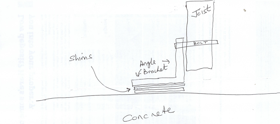

And I assume the shim(s) are placed not under the actual joist but under the bracket like this diagramScreenshot 2025-09-17 063120.pngScreenshot 2025-09-17 063223.pngScreenshot 2025-09-17 063317.png

Hi @Henry1,
Yes, you could fix the shims to the bottom of the joists with fixings. Shims typically go under the joists, not the bracket. If there is a need to shim the bracket, it would be best to use larger brackets instead. Ankascrews would be suitable and you'd need at least 40mm of their length into the concrete, so the 50mm you've shown would be suitable dependant on the thickness of the shims, if you're using them under the bracket.
