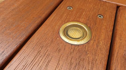

Meanwhile, I had one last question for you experienced folks. I used the Aquadeck (Natural) for the merbau decking. Before applying 2 coats of that, I had already installed the deck lights (Brilliant Lighting - Lennox, warm white, 10 pack). After applying the Aquadeck, I realized it stained the stainless steel cover of the deck lights. What would be the best way to remove the stains from the deck lights?

Since Aquadeck is a water-based product, I would suggest you try to remove the stain on your deck lights with warm water and a toothbrush. Some dishwashing detergent added to the water could assist. You might also find that the coating can be scratched off the surface, but be careful not to mark your stainless steel in the process.
I am also disappointed to hear of your experience and apologise for the inconvenience caused. HPM has a smart exterior powerpoint that could control the deck lights and allow you to turn them on and off. Your current powerpoint would need to be replaced. Alternatively, there are the Valla deck lights that come with their own remote. They are also a 40mm light and should fit in the holes you have already made.

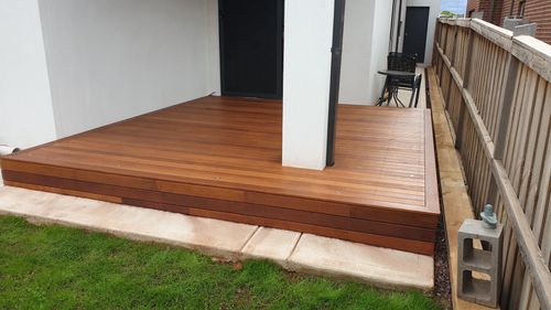

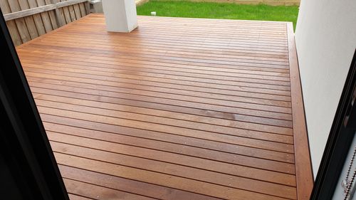

As promised, here are the pics.

The deck after 2 Aquadeck applications (from inside, looking out)
The deck (from outside, looking in.)
Tooting my own horn but I am very proud of the crisp lines and cuts. ![]()
This is what I meant by the staining of the deck lights. This is supposed to be stainless steel.
Spectacular work Varun (@arian10daddy)! I particularly like your attention to detail. The way you've cut boards along their length to fill the sloping gap at the side of the deck is a work of art.
Congratulations on creating a thing of beauty. Now it time to sit back, sip some drinks and admire all your hard work.
Well done.
