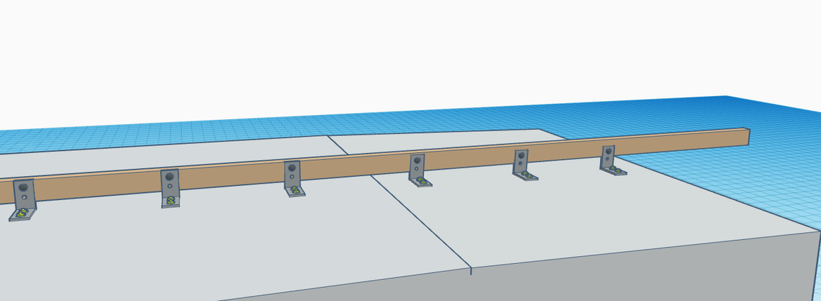

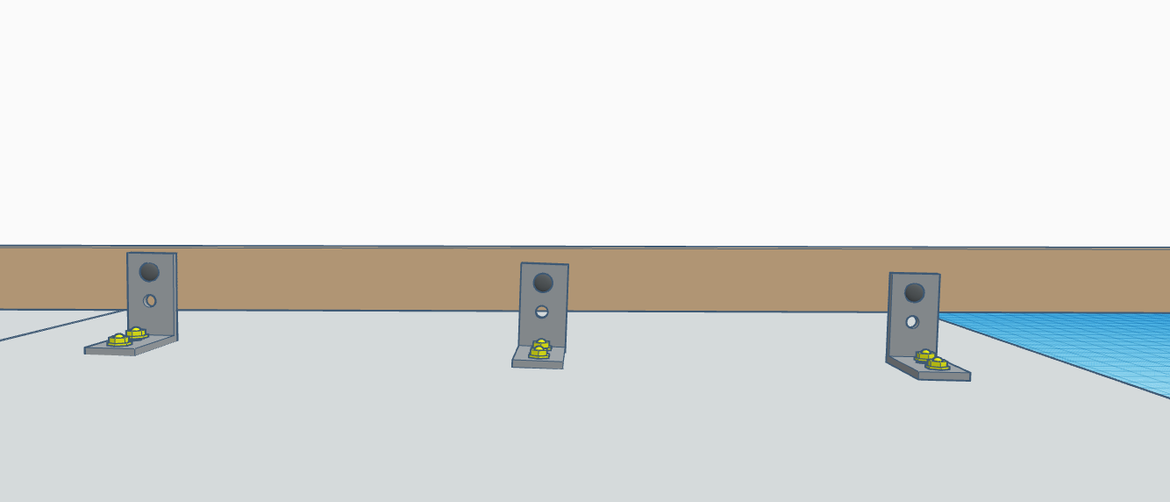

You have a couple of 1.5m spans, which would be close to the maximum allowable distance of 90 x 45mm, so consider adding additional supports. You have a single pedestal at the top centre, and it won't support both those lengths on 90 x 45mm. You either need to connect those two lengths by installing small timber sections in between them and screwing them together or adding another pedestal to support the area.
I don't believe there is any need to add a wedge under the angle brackets on the sloped area. Just fix them on the slope, and they'll work just the same as on a flat area, even though they're on a slight angle. I've put a rendering together for you below to illustrate better.

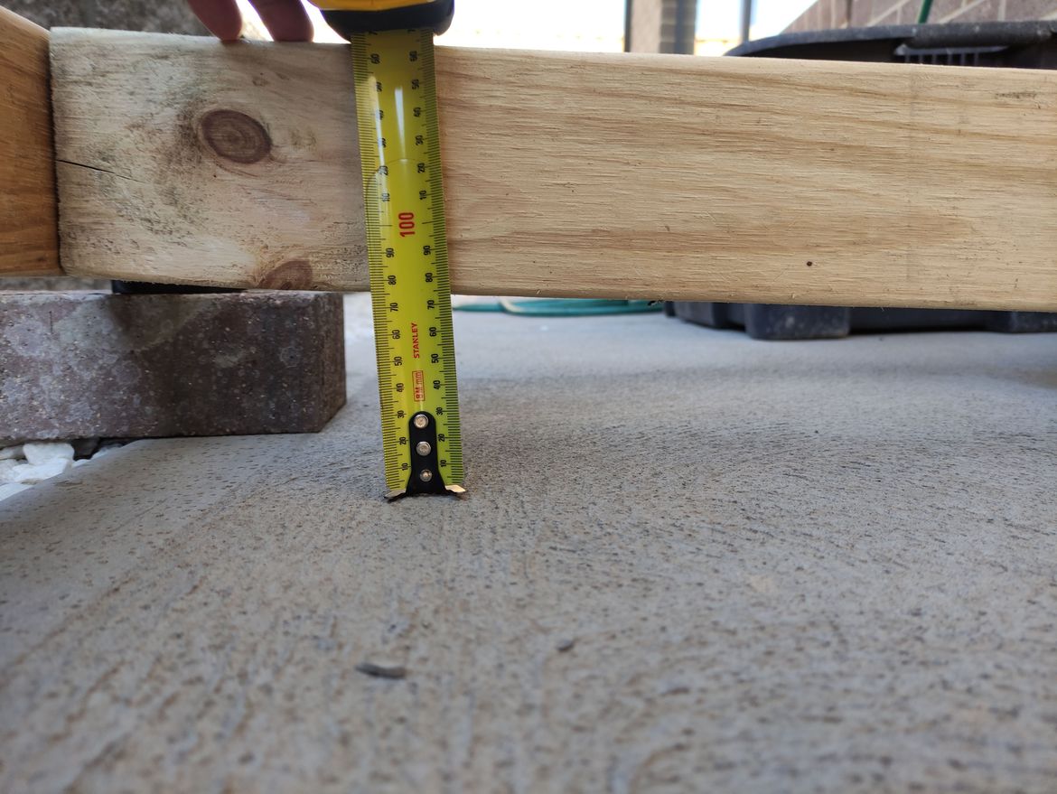

hi @MitchellMc .  i'm finally able to start on this project.  got another question. because of the slope of the concrete, there is now a clearance of about 7.5cm from timber to concrete.  Can I still use a longer angle bracket to support the timber in this case?  Do you recommend a screw or nut/bolt to fix the angle bracket to the timber?
Re: Low Level Deck Advice and Suggestions Pls
You could use larger brackets, or you might like to swap to Builders Edge 70 - 170mm Bigfoot Xl Pedestal Feet as it's starting to get relatively high @oninpena. At that height, you're likely best to use bolts to attach the brackets to the timber.
It's great to hear that you're making progress. Let us know if you have more questions.
