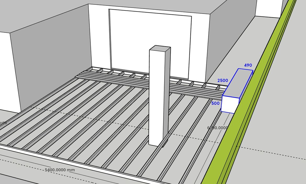

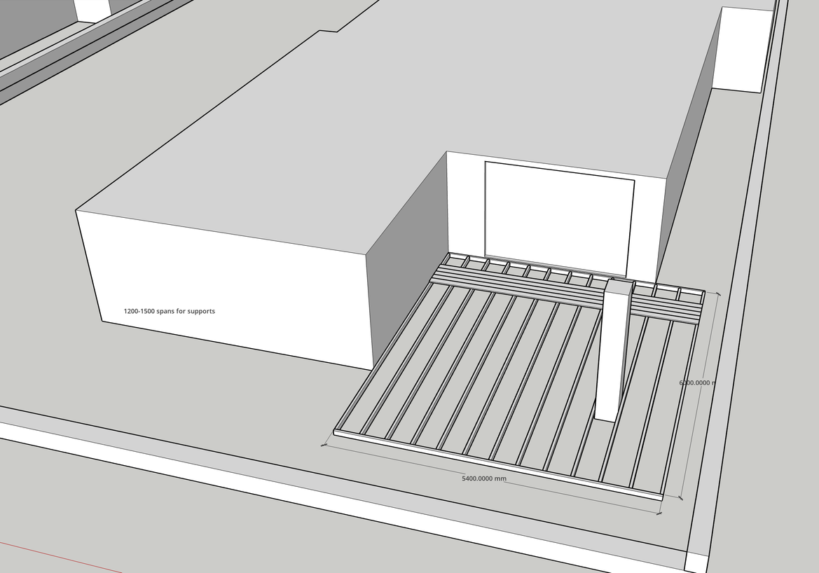

Hi we're planning on building a deck under our patio using the Ekodeck products, 90x45 H3 and the Builder's Edge pedestal feet.
Right now I'm just planning out the framing and have done some preliminary plans in SketchUp. The overall dimensions of the planned framing are 5.4x 6.09
My current questions are:
1. Do I fix the framing to the house, or just have it sitting on the pedestal feet (seems odd to not anchor it to the house but from other projects I've read about on here, it seems that the advice is just to have it float - you can see that there's also. pillar in the middle of the proposed deck that could provide more anchoring if the answer is yes)
2. Do I need to include noggins in the framing?

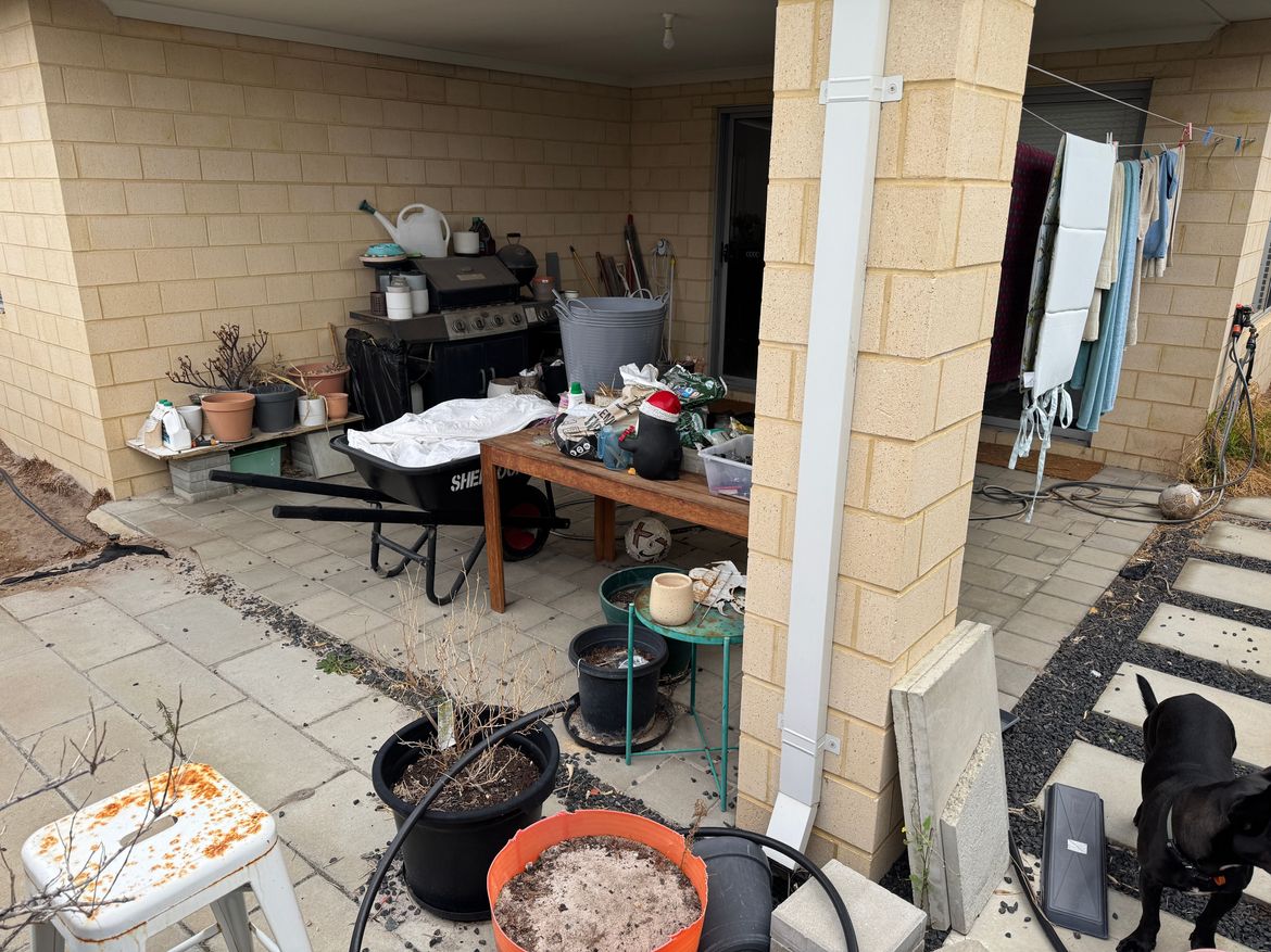

3. Currently, the patio is paved, but there is only about 85mm of clearance to the top of the future deck so those pavers are coming out. Am I right in my understanding that the pedestal feet just sit on the ground underneath the pavers or should I lower the ground some and add pavers beneath where the pedestal feet will sit to make it a little more solid?
I've attached a screenshot of my sketchup plan so far and a photo of the area.Screenshot 2025-05-05 at 2.47.07 PM.pngIMG_4644.JPG

Welcome to the Bunnings Workshop community @bradg. It's sensational to have you join us, and many thanks for your question about building a deck.
There’s usually no need to anchor a low-level deck like this to the house unless you're in a cyclonic or high-wind area. A floating deck is generally the simpler route and avoids triggering more complex structural requirements. That said, it’s best to check with your local council, as rules can vary depending on location and deck height.
Given the size of your frame, adding noggins would definitely help with rigidity. They’ll reduce the chance of joists twisting over time, especially across that 6-metre span. Even just a couple spaced along the length of each joist will make a difference.
As for the pedestal feet, they’re usually designed to sit on firm, level, compacted ground, but placing them on pavers is a good idea. It gives them a more stable base and helps distribute the load, particularly once the existing pavers are removed.
You might like to check out these helpful guides: How to build a low-level deck and How to build a deck.

HI again, thanks for all your help so far!
Planning on doing this project in the upcoming school holidays.
I have another question. I'm planning on adding a concrete bench between the limestone wall and the deck, like the images attached.
Essentially, it's a 2500mm x 490mm x ~500mm concrete box, and most of the info I find online is for pads or small concrete forms...

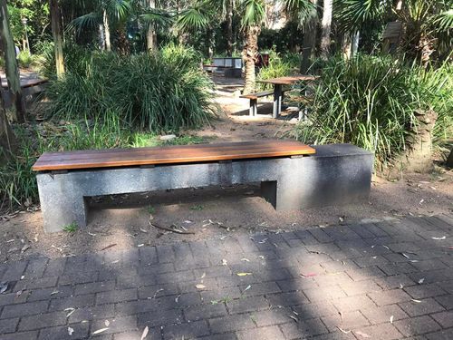

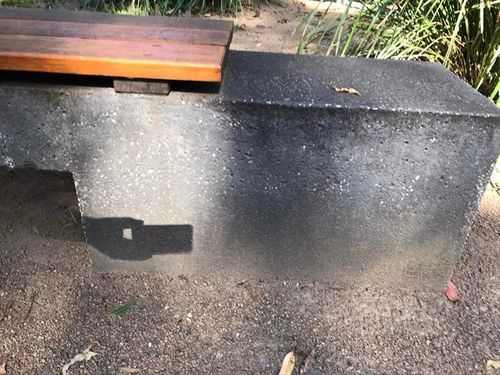

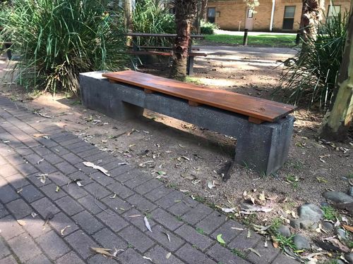

I do have a weakness for the gabion styled walls and I really like the gabion bench seat I built (Its still going strong with no issues)
However here is an alternative I have seen at work, the chunky end is half filled with stryofoam so the bench dosnt weight what you would expect. They were built on site so i would still think they are heavy. The timber has been re-oiled but easy 5 years old.
From memory they had formwork around it and then removed it after the concrete had cured.
I really dont remember them putting in a concrete slab for them to sit on, next time I walk past i will have a look.
I like how the timber slats are off teh slab, much like my gabion walls it allows air to freely circulate and dry out the timber.
