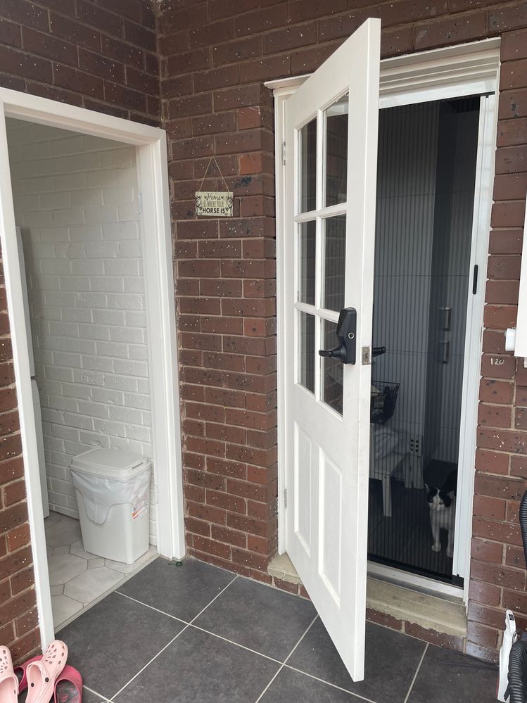

I am looking for a magnetic doorstop where I can drill one part into the door, and the other part into the brick. However I can't find one at bunnings that allows me to drill into two surfaces. It has to be magnetic to keep the door open, and it can't attach to the ground because the door clearance is too high and it'd interfere with the laundry access on the left. Can someone recommend a solution?

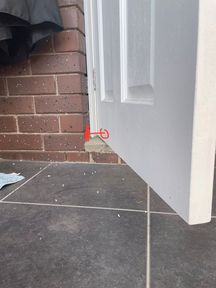

You basically need a magnetic door stop that is less than the thickness of your doorframe and can be fixed in that area. If this Adoored 40mm Satin Chrome Roll Magnet Door Stop is small enough, it can be fixed directly into the concrete door sill (not the tiled floor). The circular metal disc can then be screwed into the door. Another option might be to fix an Adoored Satin Chrome Salute Magnetic Door Stop in the orientation shown in the image and, once again, into the concrete sill.
Most magnetic door catches allow you to drill into two surfaces. They need to be fixed to both the wall/floor and the other section on the door. Since you have limited space, you'll just need to find one that suits the limited area and/or use them slightly unconventionally.
I agree with @MitchellMc 's ideas on this.
I would only add that given the short distance between the hinge and the location of the door stop, mechanical leverage will be against the magnet being able to hold the door in place, especially if it gets bumped or is subject to any wind. If that is the case you should consider using 2 magnetic catches... is it possible to mount another at the top end of the door?

To me - you're gonna have trouble drilling the holes for this one? The drill will be at an angle - and drilling will be very close to that thin concrete edge?
Constantly hitting and un-attaching the door will add to the anchoring problems?

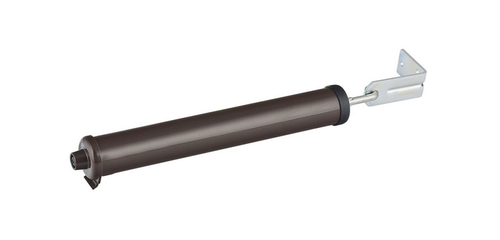

No screen door? Could you attach a humble door closer (with a 'stopping' clip) to the top of the door illustrated? Is this intended for laundry days only?

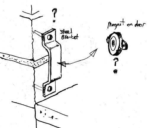

Or reverse it?
'Elevated' bracket (flattened handle?) on the bricks and a magnet on the door?
(I'll go away now)
Thank you so much for your considered suggestions. I'm actually thinking that @Noyade suggestion of a humble door closer with stopping clip might be the best suggestion, however I'm actually wondering if there's enough room for a door closer (see zoomed out photo below). If it will work, I will need to regularly use the stopping clip, so I am wondering if any of you have suggestions for a door closer with the easiest to use and accessible stopping clip mechanism. I am still open to use two magnets though but also reversing them and mounting it on the brick!

Good question @MitchellMc. The door doesn't stay open by itself and we have a retractable flyscreen door which we can't allow the door to hit against. Those simpler options could work, however the clearance between the door and bricks isn't very big, so it means a simple latch might restrict how far open we can have the door.
The advantage of a magnetic option is that we can just open the door to the magnet and it will stick, whereas the simple latches have to be latched on and off (and we sometimes are constantly opening and closing the door as we have a cat that scratches at the flyscreen which he is not allowed to do). I'm thinking @Noyade suggestion of a steel latch (in the middle of the door on the brick, and also at the bottom), and two corresponding magnets, might be a good solution. Open to other suggestions but don't want to take up too much of your time/resources!
The simple hooks were only a suggestion if you were going to look at an automatic closer, which would have been more work to un-latch every time @carpedion. The more you move the simple latch fixture on the door towards the handle side, the wider the door can open. So, it shouldn't obstruct its opening.
